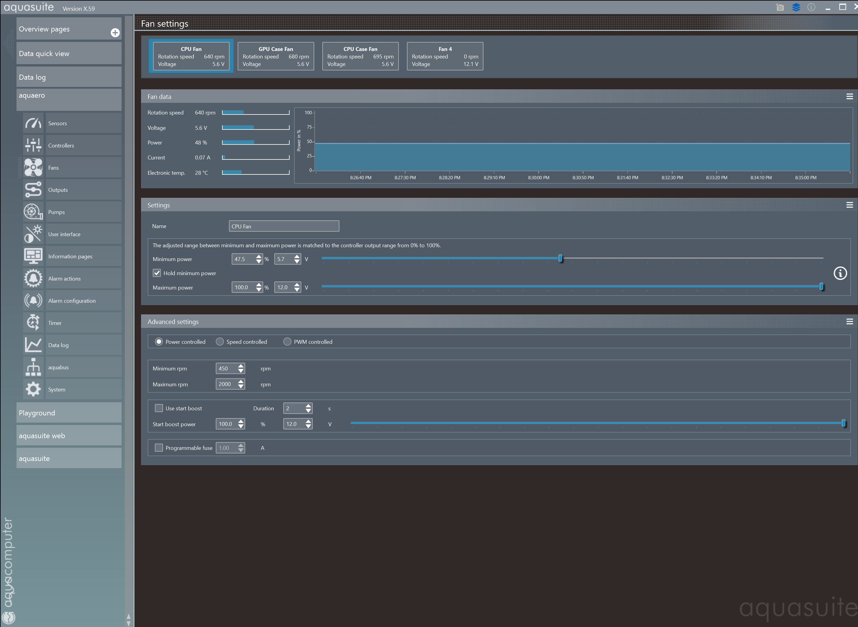

Hey guys!
I'm thinking on getting either Quadro or OCTO.
At the moment with my Aquaero which is probably decade old I'm using 3 fan channel for 4 fans which 2 of the fans from NH-D15 ( NF-A15) are on splitter connected to one channel. All my fans are controlled via Power Control (3pin) and configure in Curve Control according to my hardware (CPU and GPU) temperatures that are all I really use.
Would and of those 2 controllers have similar UI in Aquauite ?
Thanks
Dundys has attached the following images:
This post has been edited 1 times, last edit by "Dundys" (Oct 24th 2022, 2:41am)
Monday, October 24th 2022, 6:20am
If you want to continue to use your fans you can not use either of them, both are pure PWM controllers and can not control 3 pin fans.
