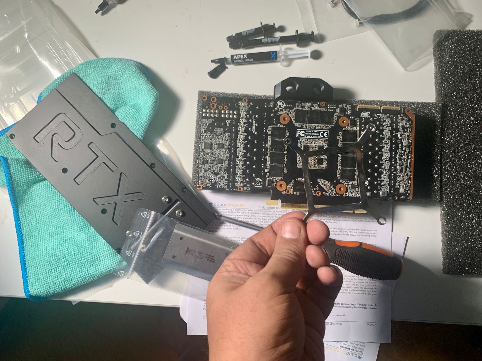

New here, I recently bought waterblock for my GPU (PNY RTX 3090 REVEL) which is a reference design. I also bought its active XCS backplate.
I am having an issue right now while installing, I completed front side and i wanted to put the screws for the main front side but I am confused do i also need to put the old gpu bracket on the back as well or no? (see in pic)
Or should i tighten this small bracket on backside first and then install active xcs backplate? pls help!
LoudAR has attached the following files:
Monday, November 7th 2022, 2:54pm
No, the original bracket is not used with watercoolers.
Just screw it on your aircooler and put it back into the box :)

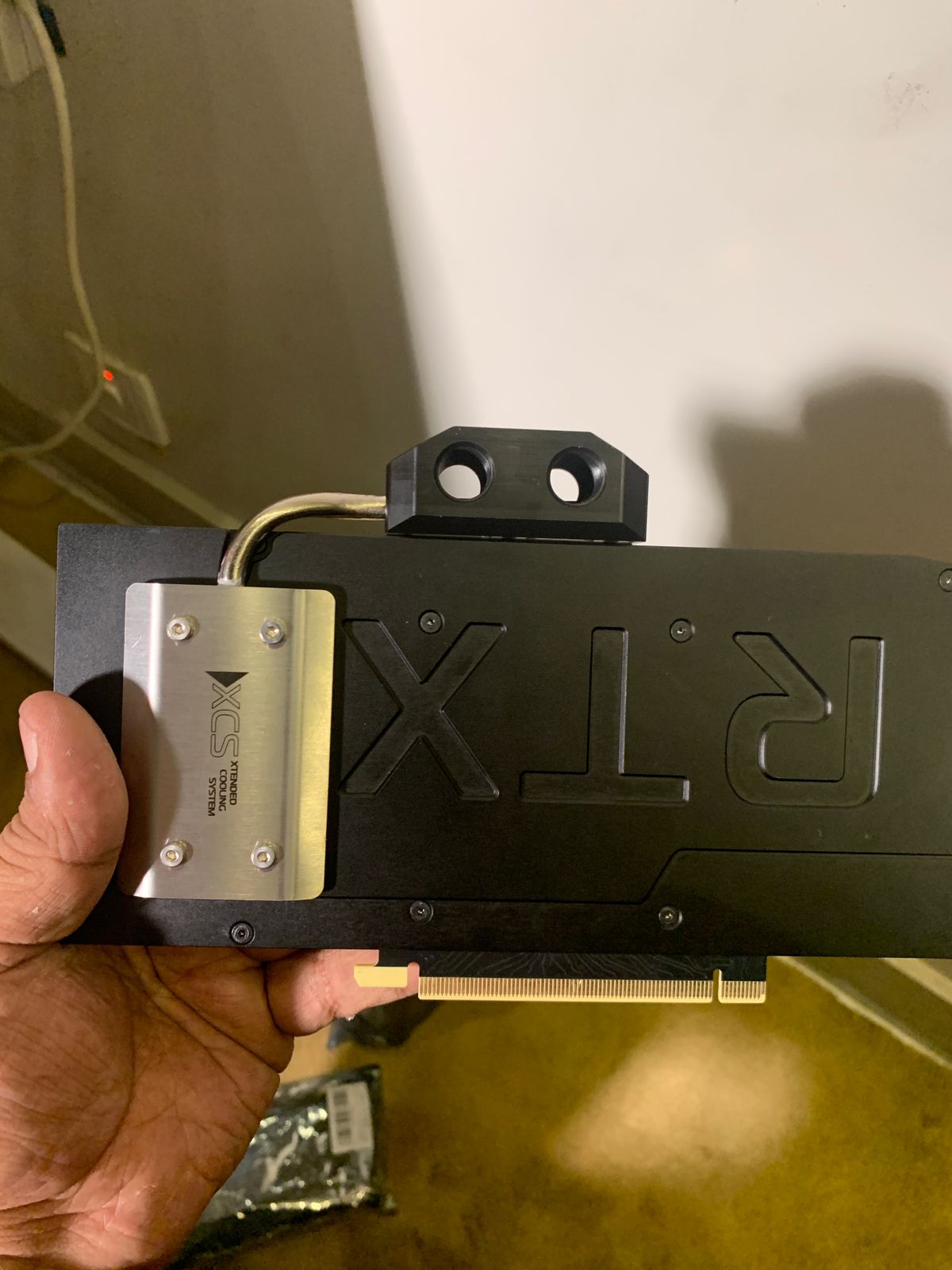

Another question which side is IN and OUT on waterblock with heat pipe(backplate)?
and also which one is IN and OUT on cuplex kryos??
Monday, November 7th 2022, 7:33pm
In the picture of the CPU cooler, the upper one is the IN, then when installed, this one is usually at the bottom.
For the GPU cooler, the left one is seen from the front.
The inlet of the cooler is generally the one that leads directly to the jetplate or sits closer to it.
Monday, November 7th 2022, 8:40pm
These are theoretically the best inputs/outputs.
In reality it doesn't make a huge difference using it the way it best fits your plumbing

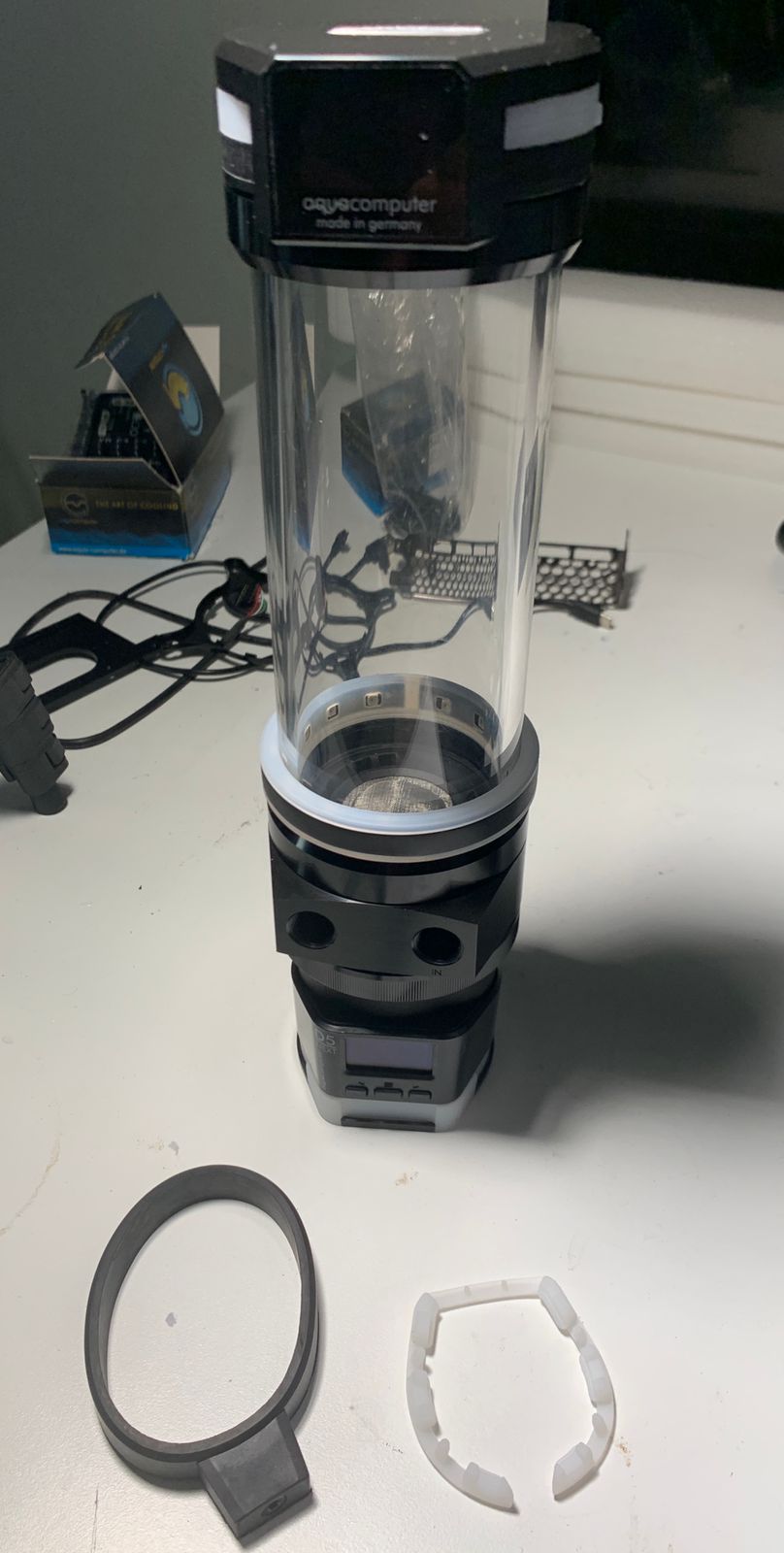

I have installed GPU and CPU waterblock, now Iam trying to understand ULTITUBE PRO 150 (Next with D5). Can you pls explain what are these two parts in front of tube? the white and black rings? are they gaskets? where should I install them?
LoudAR has attached the following file:
Tuesday, November 8th 2022, 4:09pm
The right part is a diffuser that can replace the one mounted on the bottom of the pump if you do not want to use the mounting plate on the bottom of the pump.
The left is a ring that is placed around the top of the reservoir for additional mounting, for example, on the rear wall of the housing.
