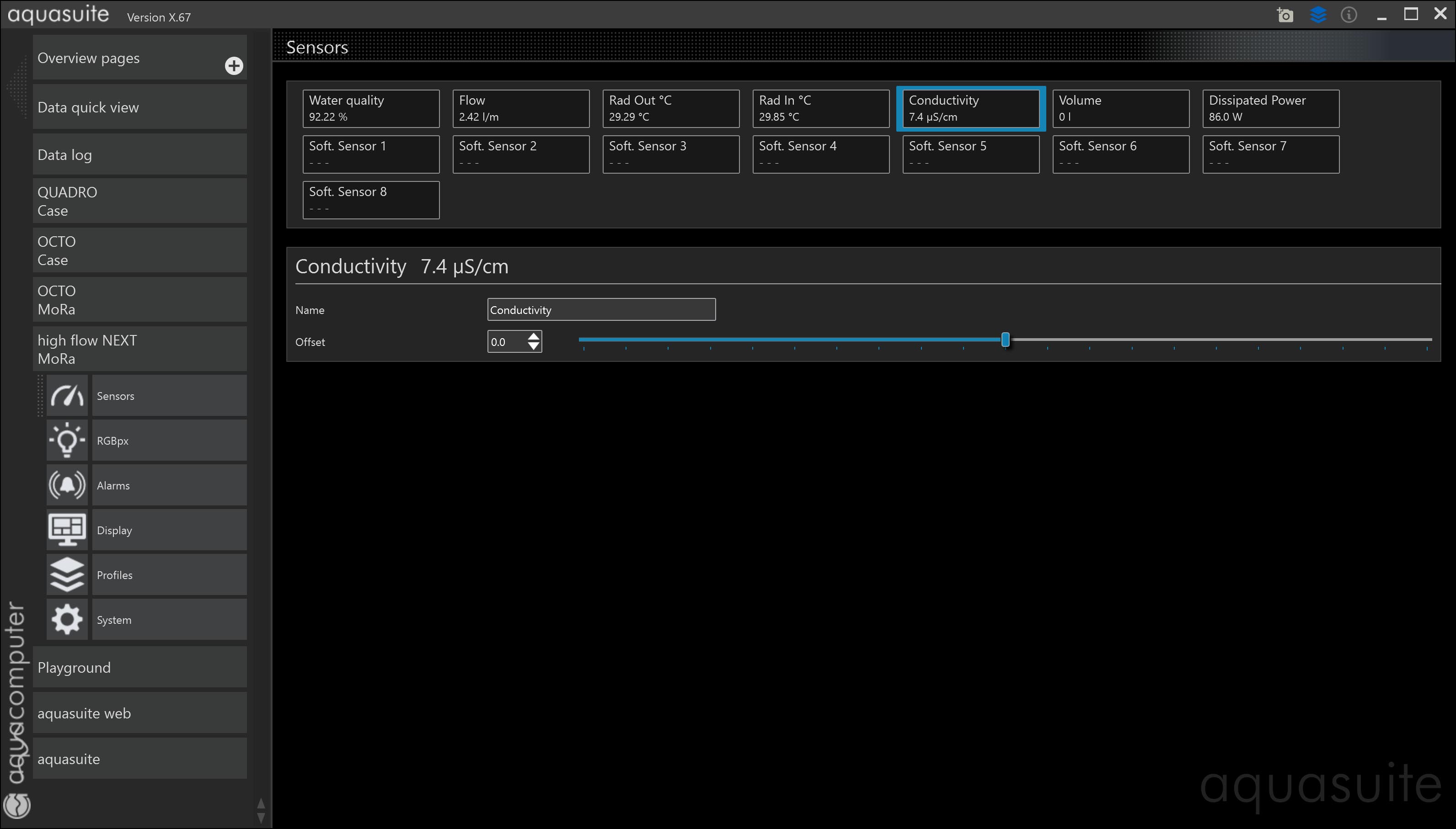

The 'Conductivity' is what it is, it is not really designed for DP Ultra
The 'Coolant quality'upper/lower limits are defaulted for DP Ultra, but can be set to accommodate most any coolant's conductivity
The initial Conductivity of any coolant should be considered a baseline, and increased conductivity over time indicates an increase of contaminants
Some coolants (Cryofuel) have additives intended to be electrically deposited over time, and I do not know how conductivity performs with that scenario
I use DP Ultra clear, and my conductivity reads 7.4 µS/cm (conductivity.jpg)
