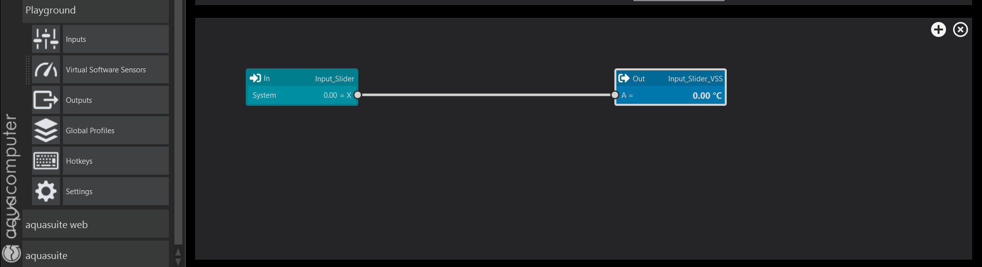

Play around with the following approach:
1. Create the slider
2. Use playground to create a virtual software sensor that accepts slider values as input and outputs the slider values as degrees C
3. Create a curve controller in the Aquaero that accepts the virtual software sensor as input, scales input(C) to output(%) 1:1 and outputs the scaled value into the target fan(s).

True - the Aquaero Curve Controllers do not accept Playground VSS DIRECTLY. But they do accept Software Temperature Sensors which may be Playground Virtual Software Sensors. So the "workaround" sequence is:
1. Create the Input Slider
2. Create the Virtual Software Sensor ( Input_Slider_VSS with temperature output ( C ) )
3. Define a Virtual Temperature Sensor ( Input_Slider_VTS ) as Input_Slider_VSS ( Correction: Define an "Aquaero Software Temperature Sensor")
4. Create the Curve Controller using Input_Slider_VTS as Input
See the attachments.

Tuesday, July 4th 2023, 8:50pm
Thank you demilleroh, that works great.
My problem was I saw the Software sensor source 'virtual sensor' option and assumed it was the aquaero's internal virtual sensors.
Here is to a quick VIDEO showing the steps involved.
