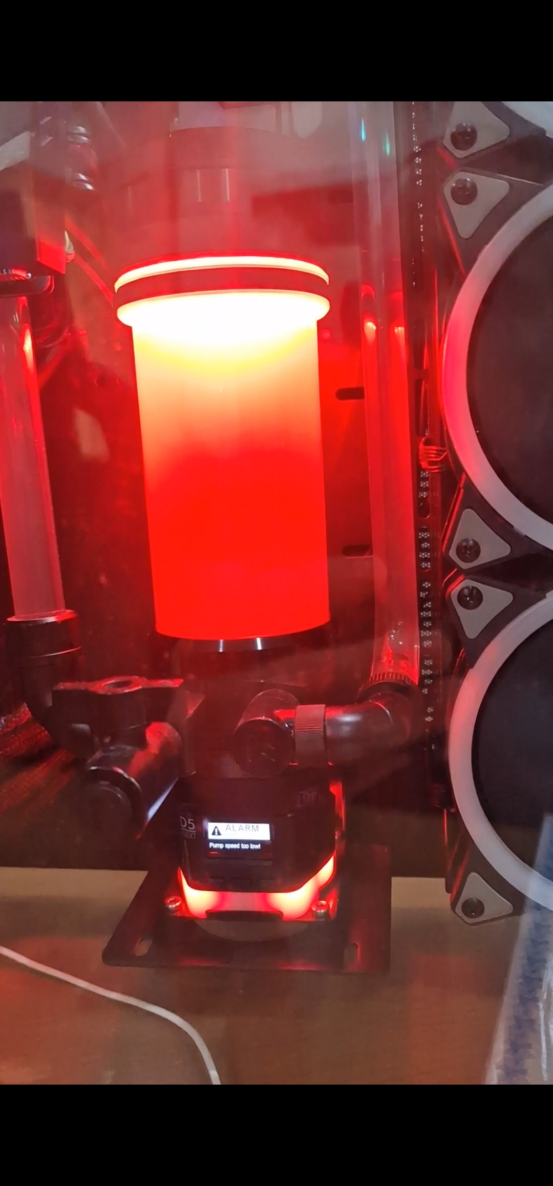

I had the following problem. About 6 months ago (I don't remember the exact time) I replaced the water pump with a new one (the base to the tank cracked on the old one and there was no way to replace it). I decided to get Aquasuite's D5 Next tank combo. The pump was working fine until about a month ago. The problem is that when I start the computer and the system detects that there is no rotation of the pump or Pump speed is too low. Blinks, write different each time between 2-30 seconds. Apparently, at different times, the current also starts, and I don't know what is happening. This happened since my last coolant change, but I don't believe it's because I updated the bios on the bottom the same day. I made all kinds of attempts, put in a new bios, changed the usb ports on the bottom for the controller, the cable to the power supply is independent, i.e. direct, and still the same. I looked around other forums for the same problem, there are similar ones, but not my case. All I have to do is reinstall the computer, but I'm looking for this to be the last option, because I have a lot of things to fix later, including settings for 3D printing programs. A lot of time wasting will take. I have a video of the problem, but I don't know how to upload it.
Edit:I just want to point out that after the alarm that I gave is between 2-30 seconds different every time, the pump starts normally and works normally without any problems.

The Alarm of the pump is hardware based, and has nothing to do with Bios / Operating System / USB. Reinstalling the computer will not help.
What coolant are you using?
Drain the coolant, remove the pump from the reservoir and inspect it..
Does the pump wheel spin easily? is the ceramic bearing free of residue?
A bad power supply can also cause the pump to start up late, if the 12V power is not delivered properly.
Edit: Please unplug the USB connection of the pump first, and see if the Alarm goes away.
If it does, maybe disable USB standby power in the Mainboard BIOS.

I using EK Cryo.
I already did this. Everythyng work/spin normal.
This morning i disconnected power cable and connect again, i swapped usb cable from the usb1 to usb2 on the mainboard.
And when i turn on after all , is the same.
Only one i can try : to disable from bios usb standby power.
Interesting is before my bios update month ago everything was same and this prbolem never happened .
