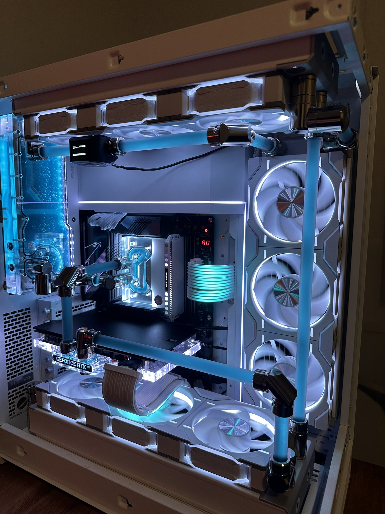

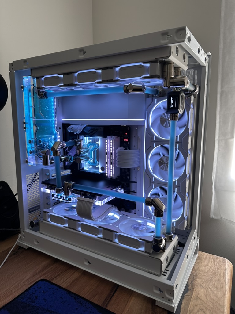

Hi thanks for the reply, I really do appreciate any help I can get with this one.
I have uploaded several photos one of the old orientation and one of the new orientation.
In any case if I spin the unit 180 degrees I won't be able to see the screen at all. However I could potentially do that just to see if it starts registering the flow but It wouldn't help if it's internally making some kind of connection.
I can also hear the rotor spinning its like the unit has just decided to stop counting the flow even though it clearly has flow moving through it.

Nice looking rig! Are those Phanteks D30-120mm or D30-140mm?
Why did you mount it upside down in the horizontal position? The manual says the High Flow Next does not care which direction the flow is. You could flip it 180° and have the coolant pass through it in the opposite direction. I guess you could not get to the buttons due to how close it is to the upper rad, but if it is connected via USB, you really don't need to use the buttons anyway. Can you mount it in the run from the GPU to the lower rad? That is a nice straight run and I think it would look good there assuming it does not cause the tubing to sag. If you mounted it in that run close to the GPU fitting maybe it could sit on the GPU back plate to support it (if its not too hot there).
Yes I am suggesting to spin it 180° just to test it and see if it starts reporting flow rate but I don't see why you can't just flip it around so the buttons are up (assuming you are OK with not being able to reach the buttons).
I have a High Flow Next in a test loop using soft tubing, sitting on a desk. It would be easy for me to invert it and see if it stops working. I will do so later tonight and let you know what happens.

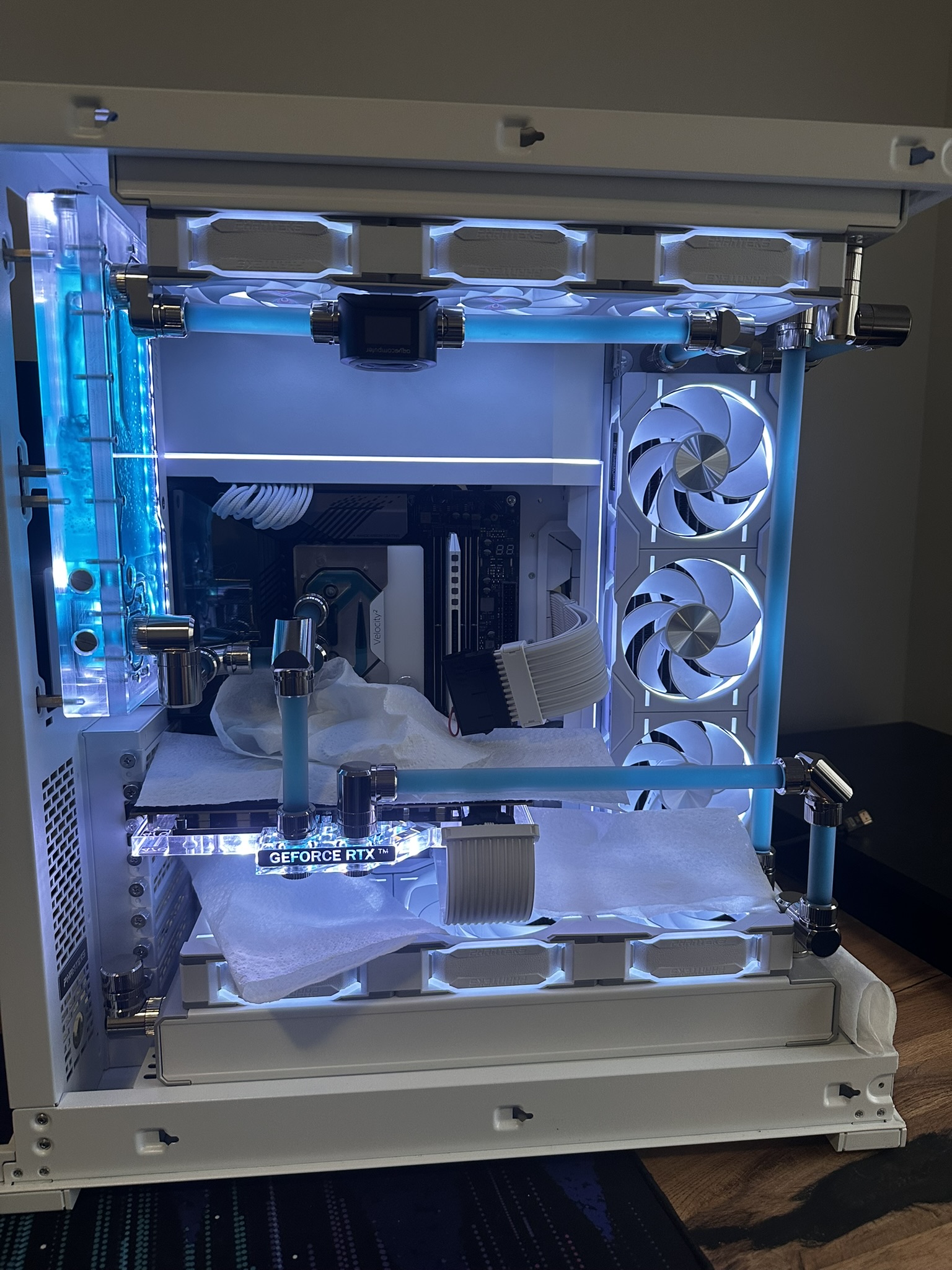

Yeah they are Phanteks d30's
So all good points, but I can't flip it the other way around because it hits the fans due to the thickness and where the ports are as they aren't centered on the unit.
I originally tried to do It from the gpu to the radiator but this unit is so thick it hit the glass because the GPU block stands out further than average. After that I tried vertical but it was making a ticking noise at 150 Litres per minute which is why I assume they say they recommend doing it horizontal appose to vertical. That and I didn't like the screen being sideways.
Which is why I ended up mounting it where I did as it was the only other place in my loop. I also know your meant to have about 10cm run between angled fittings to give it the most accurate reading.
So I absolutely would flip it if I could even just to test it. But There really isn't anywhere I can.
