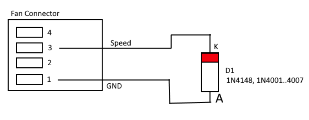

What you are observing may also be due to whatever fan(s) you are using. PWM fans are not all the same. Some will spin at max RPM if there is no PWM signal, others will stop. Some Noctua fans had a non-standard PWM implementation. Some Artic PWM fans require a diode between the PWM pin and ground to function properly when connected to an Octo or Quadro PWM port.

The Artic fans are the ones that multiple people have reported problems with when connecting to the Octo or Quadro. I don’t know if it affects Aquaero. Aquacomputer said it seems to not affect all Artic fans so maybe it was a particular batch. The posts about this are on the German forum somewhere. The solution is to install a diode between the PWM pin and ground. HERE is a post about this on the Aquacomputer support subreddit. I don’t know if your fans have this issue but it might be worth a try.
