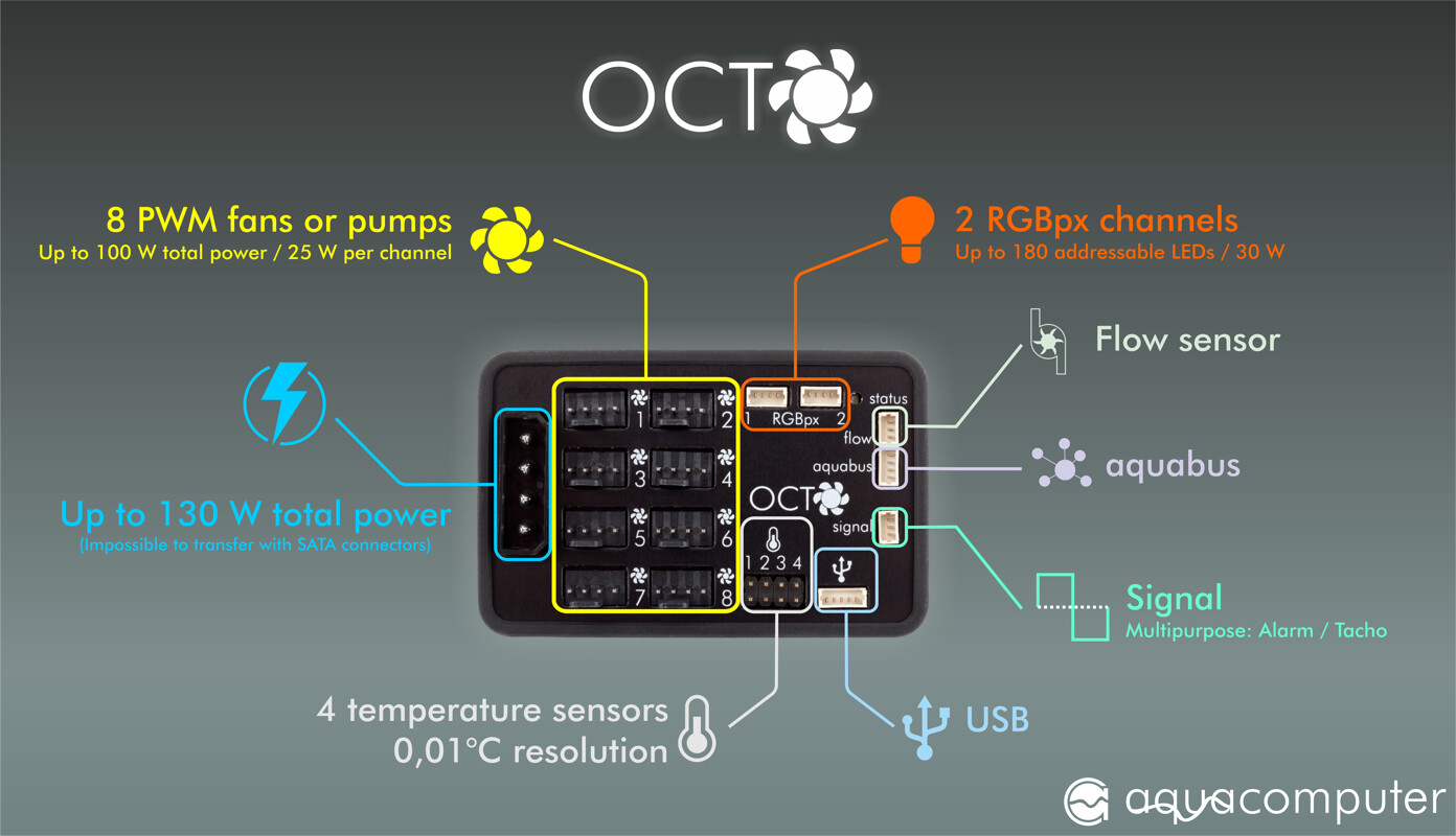

Regarding the rest of the stuff you listed, the Octo and Quadro are both excellent PWM fan controllers. The main difference between them is the Octo has 8 PWM ports and the Quadro has 4. The Octo also has 2 RGBpx lighting ports while the Quadro only has 1 but since you don't care about RGB, this is not relevant to you. The RGBpx Splitty 4 and the RGBpx Splitty12 ACTIVE are both RGBpx splitters, so if you don't care about RGB, you don't need these. The Splitty9 and Splitty9 Active are PWM splitters that allow you to connect more fans to a PWM port on an Octo or a Quadro. Whether you need either of these depends on how many fans you have and if you want to group a bunch of fans together and control them from the same PWM port.
In case you are wondering about the Aquabus ports on the Octo and the Quadro - Aquabus is a legacy serial connection that has generally been replaced by Next devices that have USB ports. If you have an Aquaero controller, you can slave an Octo or Quadro to the Aquaero controller using the Aquabus ports. If you don't have an Aquaero controller, there is really no need to use these ports.

5) Does the Quadro/Ocro and Splitty9 also plug into one of the motherboard's PWM headers like more generic powered fan hubs so that I can control it via my BIOS
6) What is the maximum current for each fan header on the Quadro/Octo and Splitty9. Not the total, but the total for a single header. I believe I read 25 W so basically each header is rated for up to 2 A (12 V)? Is that correct? I know most powered fan headers tend to only be rated up to 1 A so I just want to be certain since I have some fairly powerful fans.

5.) QUADRO and OCTO are fans controllers and no fan hubs. They can not be connected to another fan port. Splitty on the other hand can be connected to other fan ports. As already mentioned its only purpose is to split the input signal onto several outputs.
6.) QUADRO and OCTO can handle up to 25W per fan port. In case of OCTO you have to keep in mind that the total load is limited to 100W. Splitty9 is no fan controller. I would try to stay below 35W, otherwise the circuit paths will start to become warm/hot if the load is too high.
What do you mean by fan controller and not fan hubs, I thought those are the same things? So, in terms of powering and controlling fans, how is the Quadro/Octo different from a Splitty9 Active?
How can the Quadro and Octo handle 100 W total and 25 W per fan port if they are not powered? I don't see a molex or SATA connector on them.
My mistake, I meant the Splitty9 Active - which looks like the only Splitty model that's actually powered (SATA). What is it's max total power and max power per header?
Look again – The Octo and Quadro both have a 4-pin Molex header on the left side of face plate. It’s the biggest connector on them. For the rest of your questions. I think you will find the answers if you download and read the product manuals.

More or less like that. In QUADRO/OCTO you have to set up a software sensor and assign the temperature of the flow sensor or pump as data source. This newly created software sensor can then be used as data source a fan curve for example. Since these devices can not tallk to each other in a direct way, this only works when Windows and the Aqua Computer background service is running. You can define fallback values for the system start or other unexpected situations where QUADRO/OCTO receive no data.
Quoted
QUADRO/OCTO and also the pump and flow sensor have a microcontroller to process most stuff completely autonomously. Through the software you can configure and monitor these devices.
Splitty9 (Active) on the other side are just dumb and have no microcontroller or USB interface. You can not control or monitor them.
