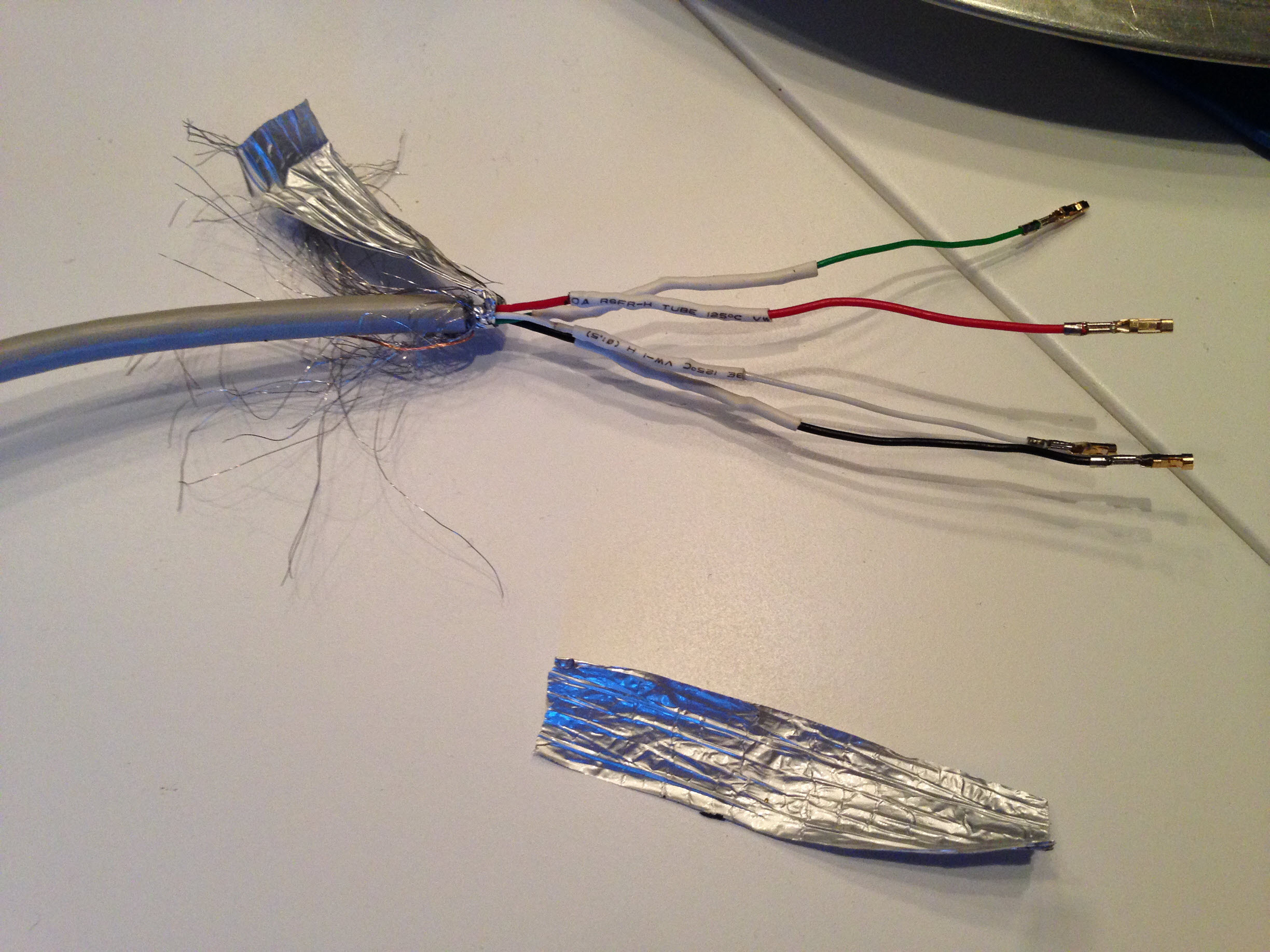

I'm not enough of an electrician to tell about ways to circumvent it, except one way (to circumvent using shield): buy sleeve with shielding properties:
Conductive Braiding http://www.kustompcs.co.uk/acatalog/Conductive_Braiding.html (I havn't bought this, as it is expensive to buy just 1 item and have it shipped over)
It's important to remember that the shield is not to shield the USB cable, but to shield everything else from the USB cable - Maybe someone at Aquacomputer can tell us wheter the USB cables used for their devices are particularily noisy, or if we can do without the shielding.
It might not be necessary at all. Was much worse a decade or two ago, but I have had issues with onboard sound and EMI noise.
How I did it:
I redid the shielding like this - I'm sure it can be made in a neater way - I also havn't measured it with some measurement-tool, as I don't have any that can do it.:)
(I did tidy up the solderings before putting on heatshrink)(
Putting heatshrink over the foil-shield to keep it in place, and to insolate it from the mesh
Dintid has attached the following image:
