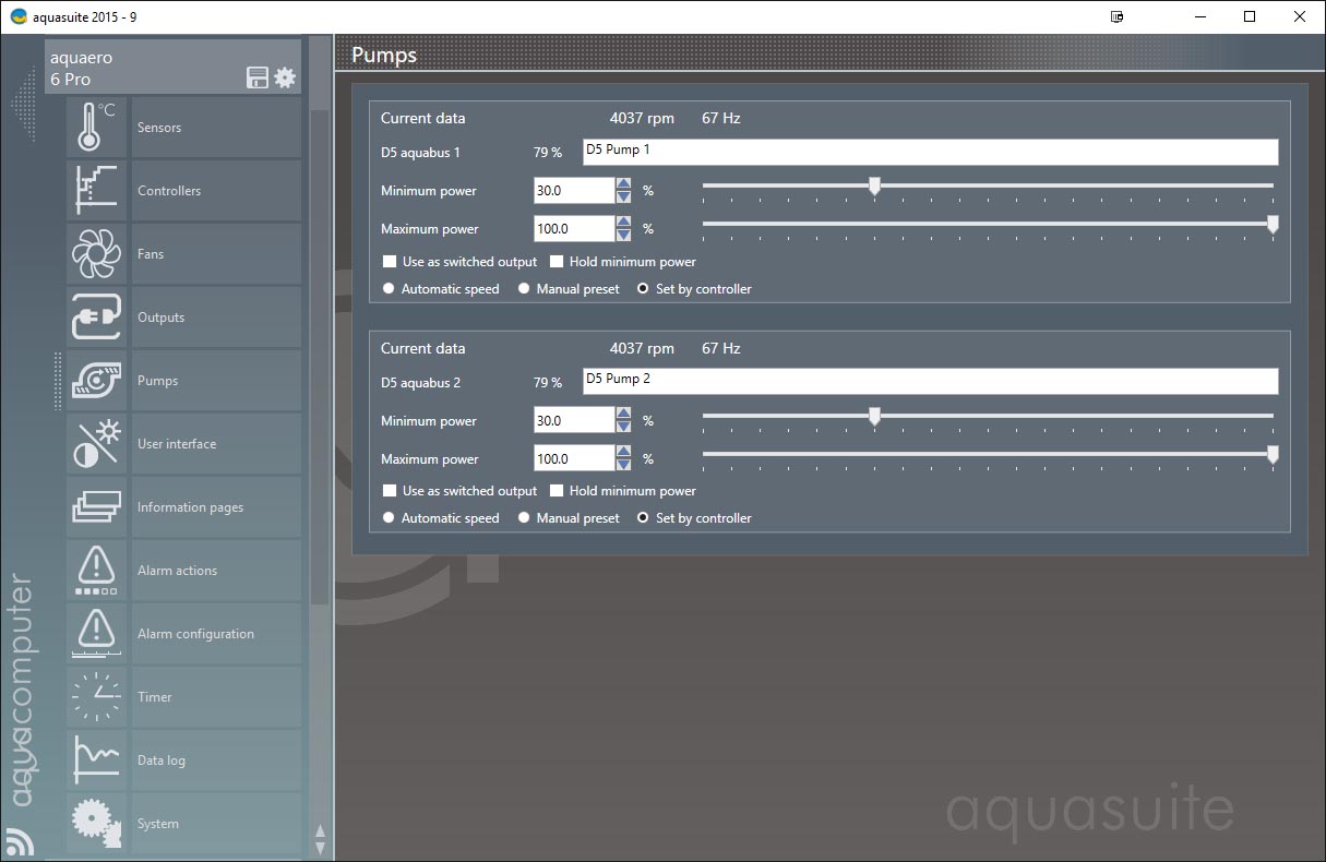

Can you post a screen shot of your pumps tab in aquasuite? (example below)

Thx for the answer, here the screen of the pump and the flow

I am not sure if the Minimum/Maximum power settings on your pump are used with the automatic control option, but having it at 100% for minimum and maximum could force the pump to 100%... which may have been your intent.

As a test, you could set your "Minimum pump value" to 30%, leave the "Maximum pump value" at 100%, then use the "Manual preset" option to move the pump power up/down and see what happens to the flow rate.
