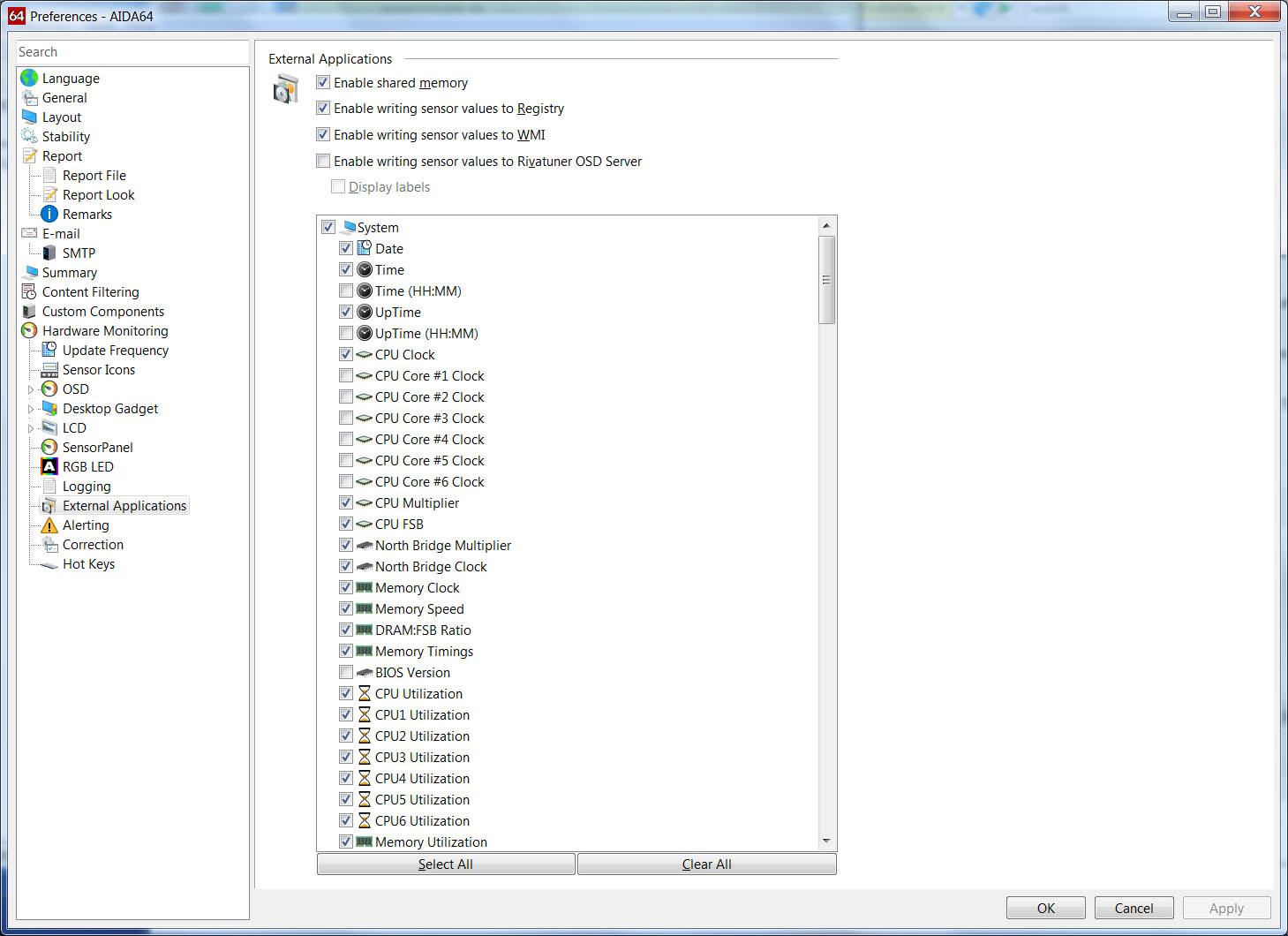

Aida 64 (5.80.4000) is running, and has the options 'Enable shared memory', and 'Enable writing sensor values to WMI' selected as I had in the past. I even tried selecting 'Enable writing sensor values to registry', but that didn't help. (See aida64-sensors.jpg).
'Untitled-3.jpg' shows the old 2015-9 using software sensor 'aida64:tcpu_0:CPU', for example. The only thing that was changed between working and not working was the Aquasuite version. When that didn't work, I updated Aida64, which also didn't help.
