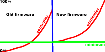

On previous firmware, nothing was changed when I set "minimum power/rmp" below current value. And after that, the current rmp/power can not be smaller than the minimum value. It works logically and I always enjoyed these settings.
Now in new firmware I create controller with "preset value" and set power to 50% ( 6V ). The fan speed is 1135 rpm.
When I set minimum power to 33% ( 4V ), the voltage grows from 6V to 8V ( from 1135 to 1417 rpm )
When I set minimum speed to 600 rpm, the rpm grows from 1135 to 1279 rpm ( from 6V to 7V )
Option "hold minimum power" is always enabled even checkbox is clear.
I do not understand how it works, and what is now means "minimum" power/rpm in CURRENT firmware.
This post has been edited 1 times, last edit by "Nickie" (Jan 14th 2017, 8:35am)

Nickie
Saturday, January 14th 2017, 8:03pm
Thank you! Now I understand how it works
This has always been this way.
No, in 2012(13?) it works as on left picture
This post has been edited 1 times, last edit by "Nickie" (Jan 14th 2017, 8:04pm)
Saturday, January 14th 2017, 9:03pm
No September 2012 it has already been so.
