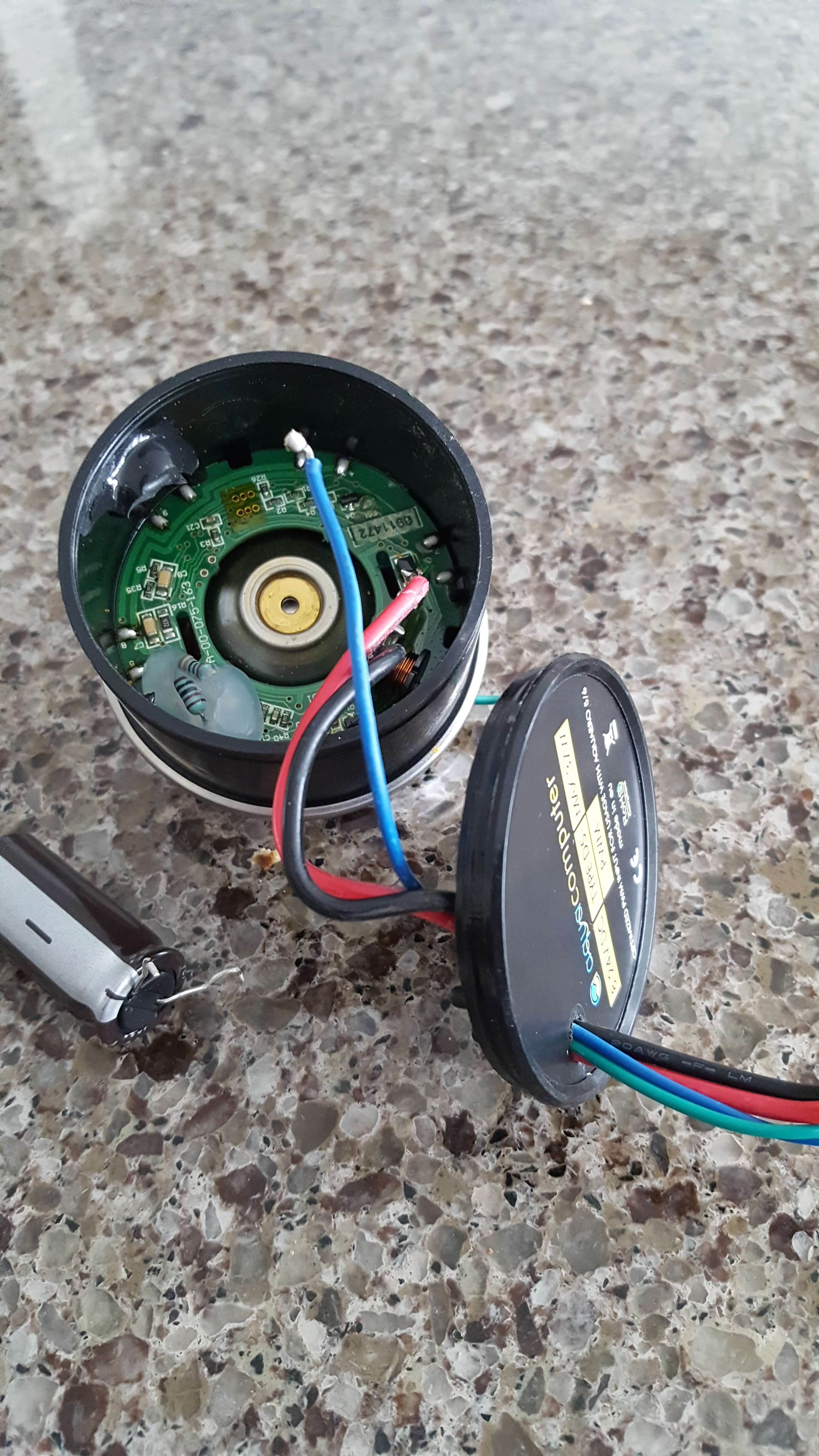

Dundys
Sunday, December 17th 2017, 2:16am
I finally found quick and simple solution to my dead D5 pump problem.
Every time I would go to my office and I would see the pump sitting on my desk it would bug me, not because the pump was defective, but because the pump was new and defective, that is a big difference.
I was talking to Sven but all of the sudden our communication hit dead end, that's OK I wasn't going to drag this to long and if I feel that I'm losing connection with the source, there is no point on going any further.
Quick fix and it worked great, out of sight out of mind ;)
Dundys has attached the following files:
  • 2.jpg (858.58 kB - 118 times downloaded - Last download: Sep 15th 2026, 10:05pm)
  • 1.jpg (800.66 kB - 117 times downloaded - Last download: Sep 30th 2026, 1:02pm)
This post has been edited 3 times, last edit by "Dundys" (Dec 17th 2017, 2:19am)
