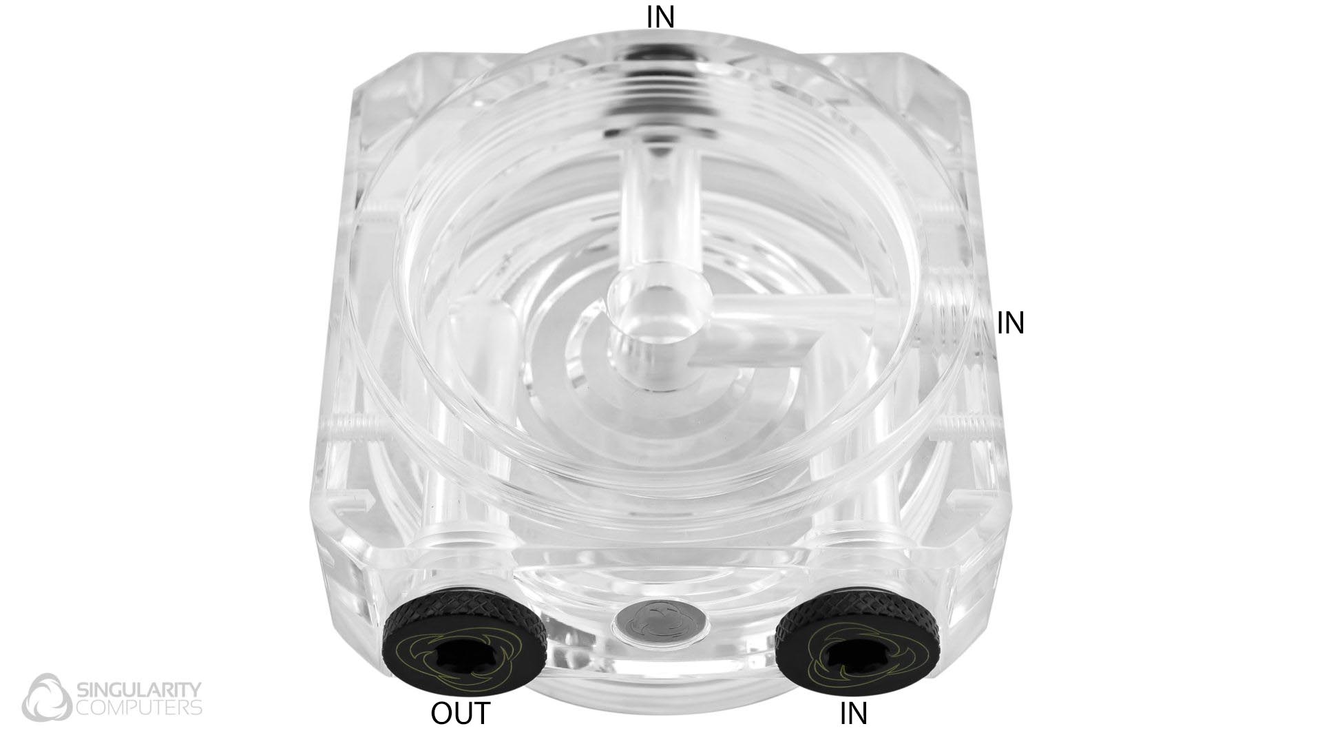

Tuesday, February 18th 2020, 5:06am
Which pump top/rez combo is that?
Maki911
Saturday, February 22nd 2020, 11:49pm
Singularity Computer combo on D5 NEXT Pumps....
Sunday, February 23rd 2020, 5:45am
If THIS is the pump, then looking at one of the images, it appears you have 3 inlet ports and one discharge port.
If this is what you have, then you could connect the pressure sensor high side to any of the 3 inlet G1/4 ports on the pump top with good results. If there is a bias from the fluid flowing past those ports into the center of the pump, it should be minimal and constant. I assume the important function of the sensor is to indicate change over time, not absolute accuracy.

Thanks! I didn't know that! :) If I'm going to connect two D5 next pumps with above mentioned top/res in serial config, do I need two of these sensors or one will be enough?
Sunday, February 23rd 2020, 7:03pm
My comment above assumed your return to be at the top of the reservoir.
Is this correct, or are you returning to the pump-top's IN on the first pump/rez in line?
Maki911
Sunday, February 23rd 2020, 7:35pm
You assumed right, my return will be on top of the res.
Sunday, February 23rd 2020, 8:34pm
I guess the second reservoir is for aesthetic purpose?
My methodology would have a level/pressure sensor only on the first pump/rez combo that has the return at the top.
If the purpose is to detect fluid loss due to a leak, I believe it would be the first rez to show a level drop.
Another reason I would place the sensor on the first pump, is to reduce the influence of impeller action.
The second pump top would have the first pump discharging directly into its pump top inlet, which may induce additional pressure on a sensor tied to those inlets.
Just rambling thoughts on my part.
