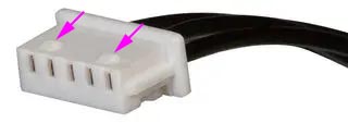

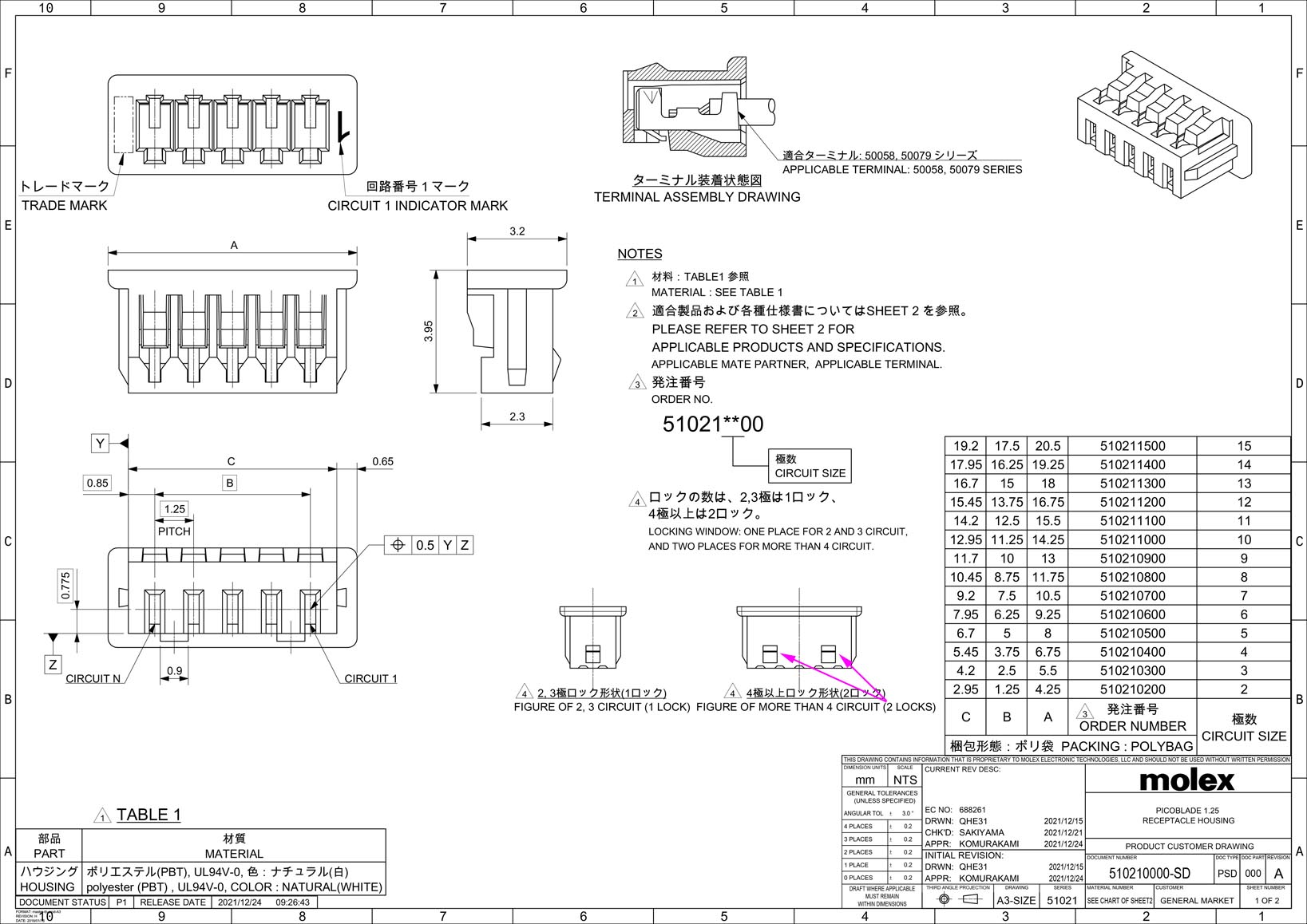

Tuesday, February 15th 2022, 2:28am
You may want to inspect the female connector on the USB cable.
There should be two small raised bumps that lock into small windows in male connector (female_pic.jpg)
Female connector (female.jpg)
Male connector (male.jpg)
If the two raised bumps on the cable connector are not there, or wore down, you may need to replace that cable.

Edit2: Looking at your comments, I am not sure which end of the USB cable is releasing... the motherboard internal header side or the Picoblade/OCTO side.
This post has been edited 2 times, last edit by "InfoSeeker" (Feb 15th 2022, 2:35am)

@InfoSeeker Motherboard side. I was thinking of looking for a Picoblade 5-pin 1.25mm to USB 10-pin cable, but that's probably too specialized. Could make it myself, or find a different solution to make the 5-pin grip better. Thanks for providing the part schematic, that's neat. I sometimes buy parts from mouser.com, to make cables fit.
