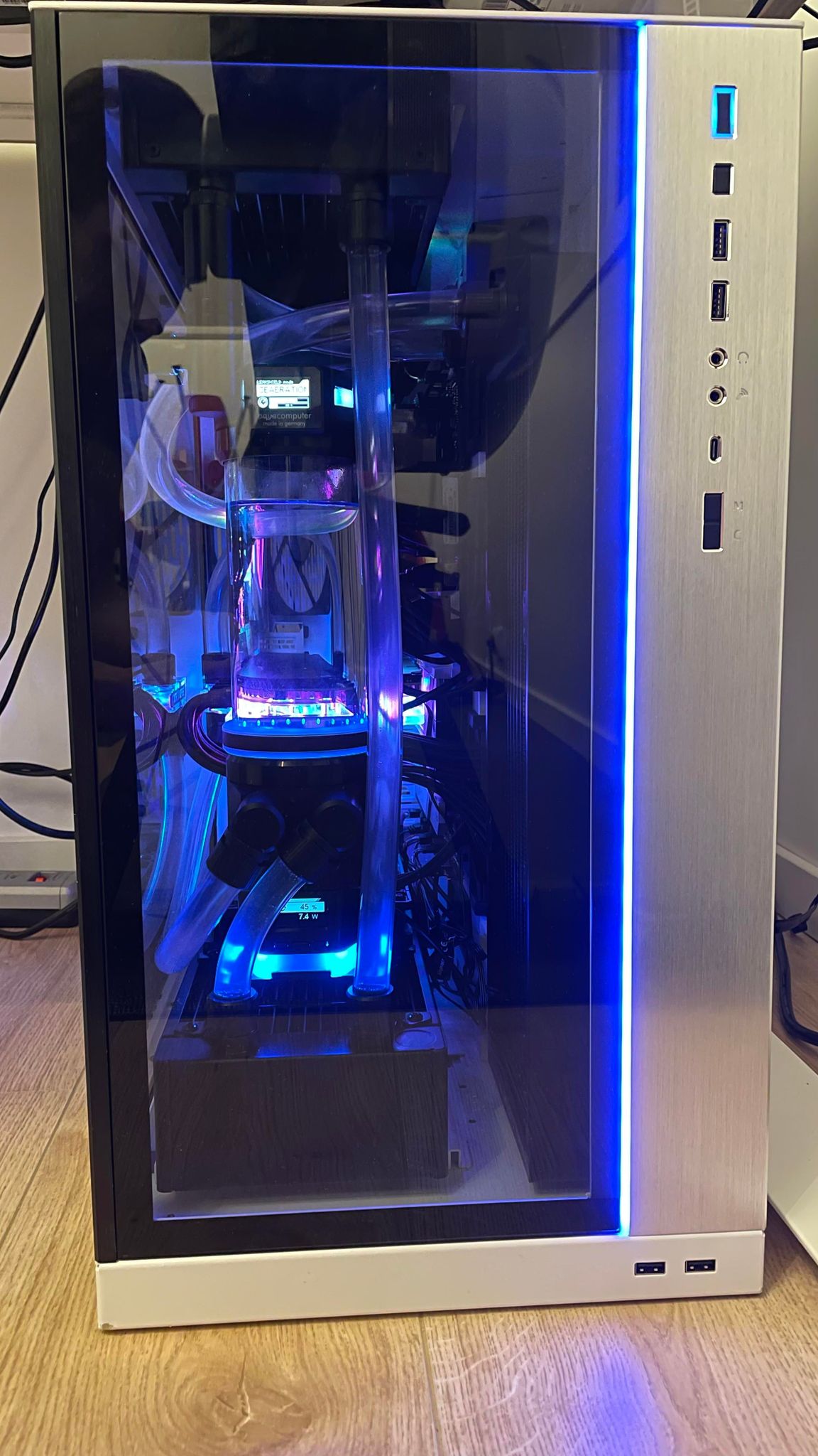

https://imgur.com/a/obIvbbi
The tubes are 16/10, it worked before i added the gpu waterblock. the coolant is distilled water and ekwb cryofuel clear from concentrate. the water level detection is always off, sometimes way off.
nighteagle123
Friday, April 15th 2022, 8:04pm
Brand new EK-DuraClear Internal diameter (ID): 9,5 mm (3/8"), Outer diameter (OD): 15,9 mm (5/8")
3x360 radiators. 1x 3080Ti with aquacool waterblook. One 12900K with EK waterblock.
Everything worked fine before I added the leakshield. It still works fine. Just that the alarm constantly goes off while gaming.
nighteagle123 has attached the following files:
  • 1.jpg (273.18 kB - 422 times downloaded - Last download: Nov 11th 2026, 2:39pm)
  • 2.jpg (306.77 kB - 448 times downloaded - Last download: Today, 5:15am)
  • 3.jpg (609.41 kB - 352 times downloaded - Last download: Nov 16th 2026, 7:42pm)
