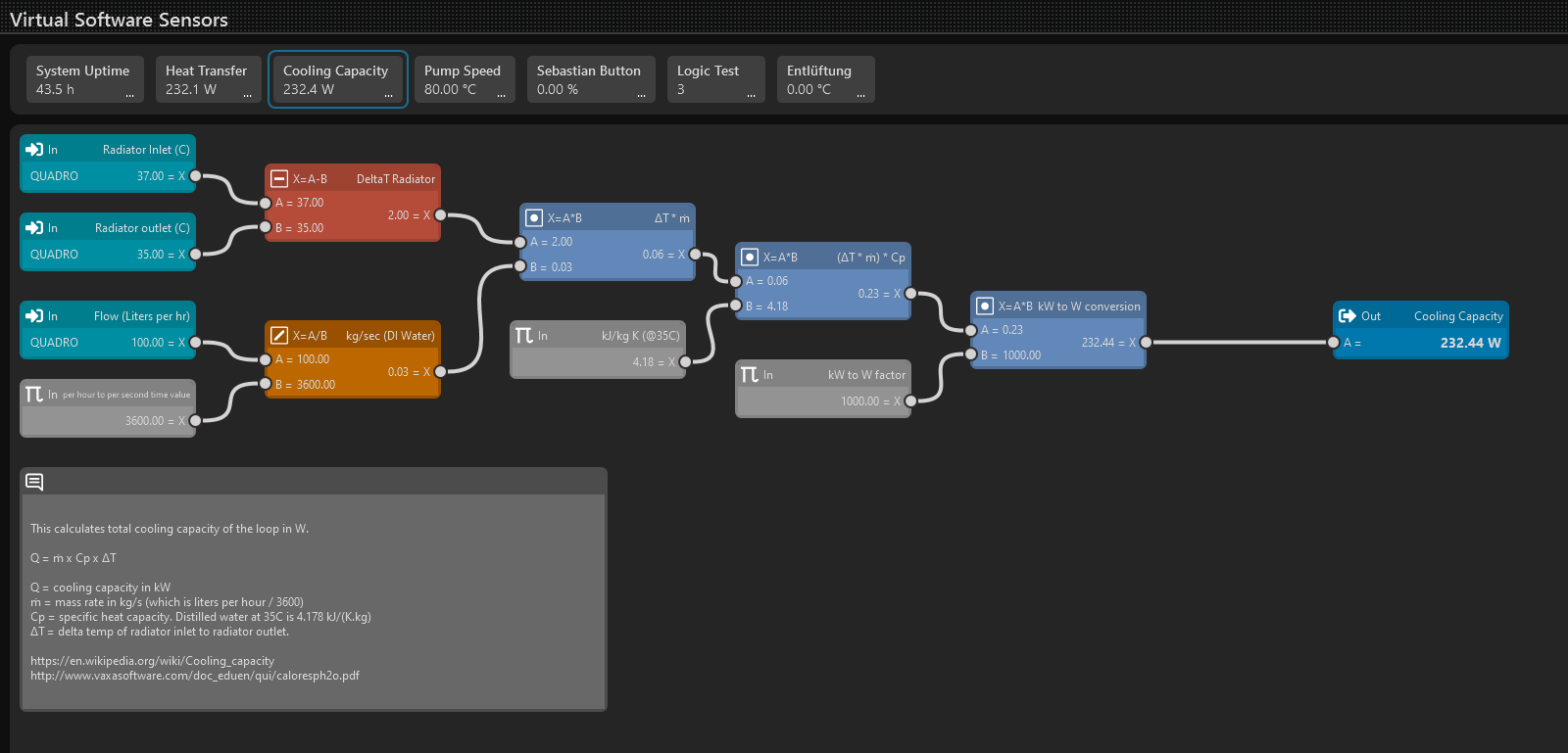

Making a virtual software sensor that is coolant temp minus ambient temp (Delta-T), then assigning that virtual sensor to one of the Quadro’s soft sensors, and then using that soft sensor to control fan speeds is a good way to start learning about the Aquasuite Playground and the concept of a virtual software sensor. These features provide a completely customizable level of control that can be used to do all sorts of interesting things. For example, if you put temp sensors at the inlet and outlet of a rad, you can use the difference in temp and the flow rate to calculate how many watts of heat the rad is dissipating. Since the whole point of increasing fan speed is to remove more heat from the coolant, this virtual software sensor allows you to see what the higher fan speed is actually doing. You can use this info to build a fan speed curve that optimizes heat transfer.
Here is a screenshot of a virtual software sensor that does this calculation. Disclosure - I grabbed this particular virtual software sensor from a REDDIT POST but it's a fairly common setup. Virtual software sensors can be exported and imported as XML files so they are easy to backup and share.
