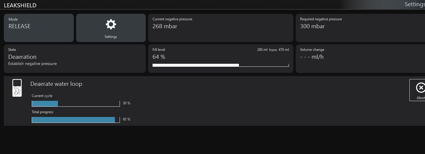

AquaSuite states required negative pressure as 300 m/bar for deaeration.
Every time I do the test, the negative pressure keeps building but as soon as it reaches 300, it immediately goes down to around 270 and then continues the deaeration cycle while at around 265-270 instead of 300. When the cycle is completed, the same process starts over.
Is this correct behavior? Is it supposed to do the test at 270-ish m/bar, not 300?
Picture is attached.

this is the normal behavior.
