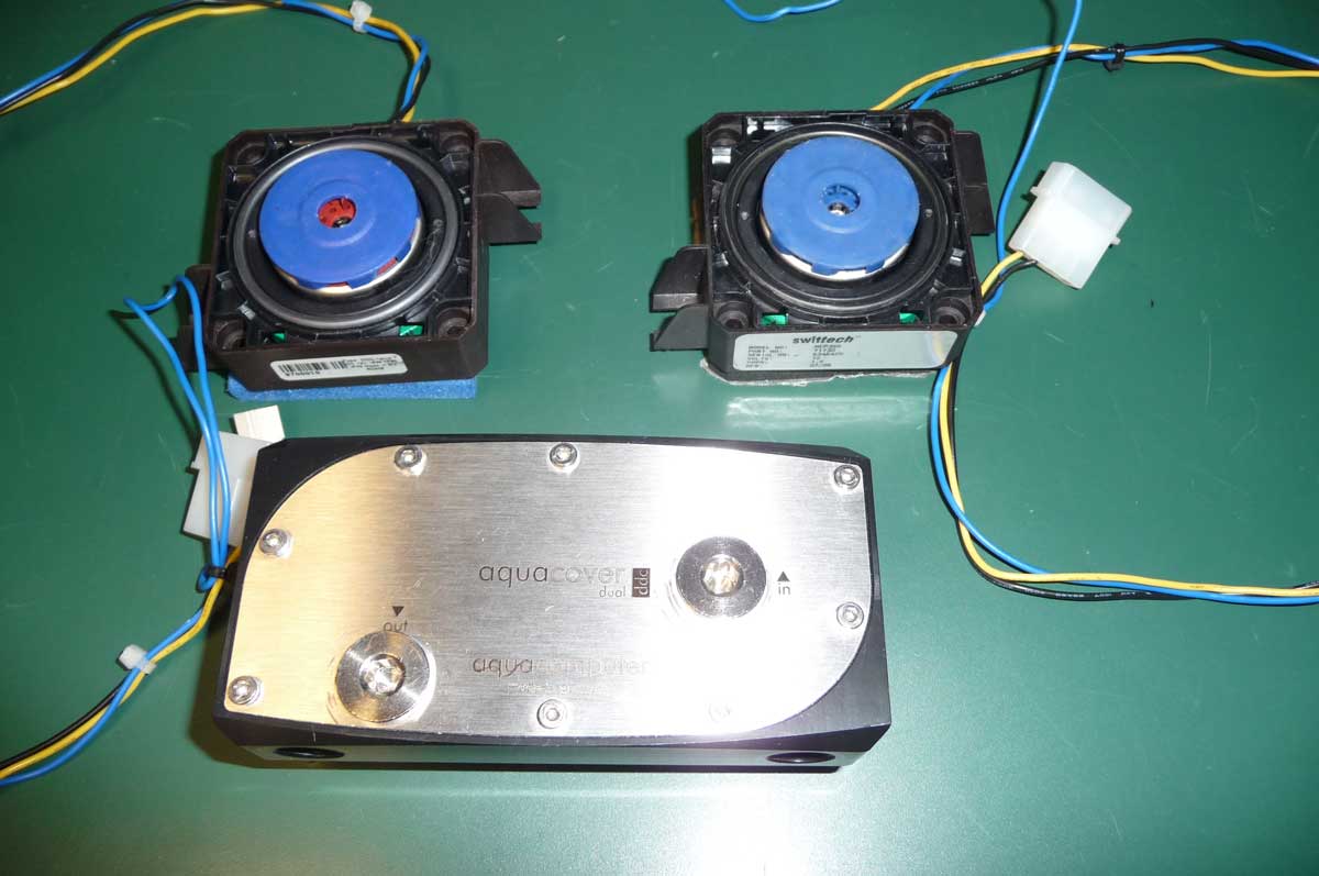

maexi has attached the following images:
