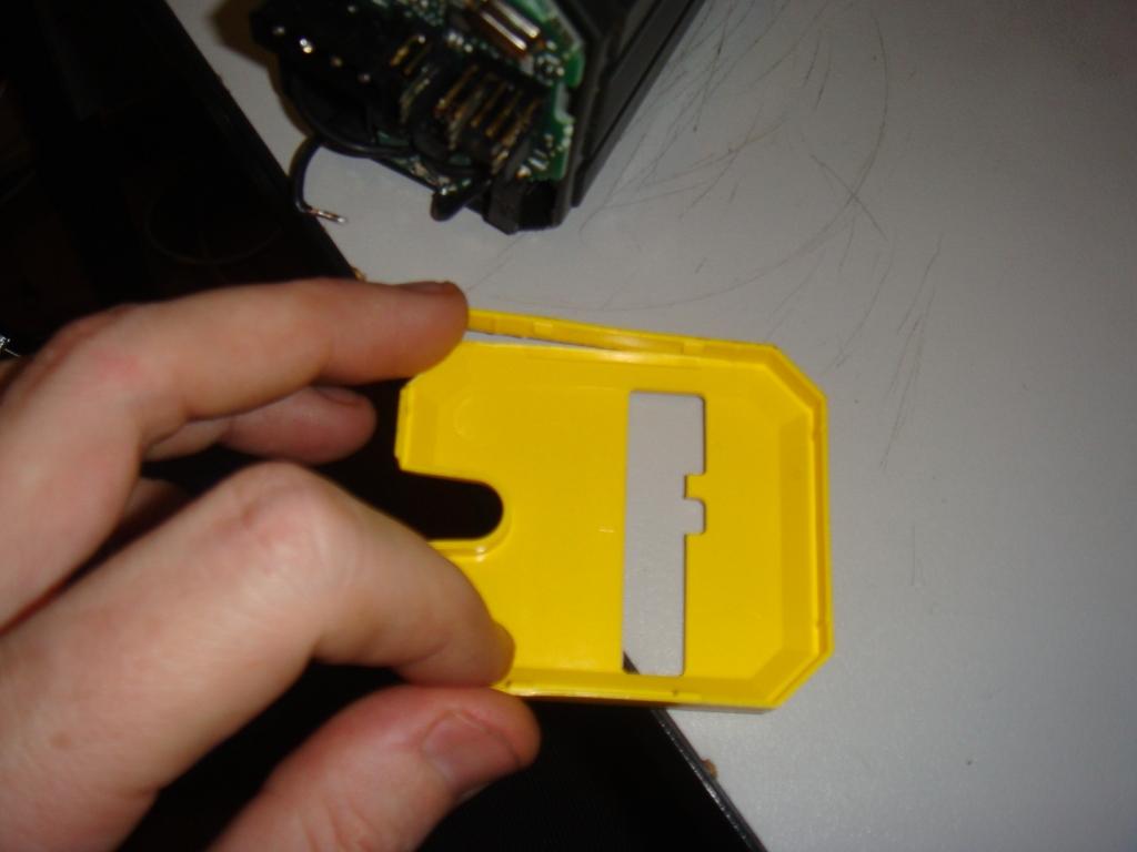

one last thing, the yellow cover on the back of my ASXT just spilt and came off..
i noticed the bulge in it due to the cable routing, but thought it was fine.
but the plastic seems to have torn on its own without any force on it.
now the rear cover wont stay on.

You could glue the yellow cap to the back of the pump or get a new one. I think there is no other way to get that fixed.

i was about to buy a 2nd ASXT but having to glue the cover back on a brand new $150 pump is not right.
i will probably RMA it.

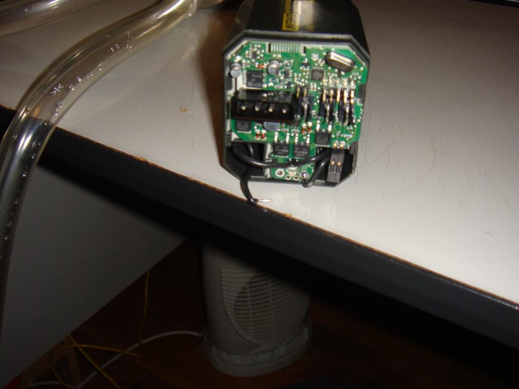

UPDATE:
just tried to reflash the asxt firmware, got error msg saying cant flash, turn off power,
and also a PUFF OF SMOKE FROM MY PUMP!!! :huh:
tried again to be sure and again saw small white puff of smoke coming from pump.
and still failed to flash,
im starting to think i have a dud here :(

Well, now you definitely have to send it in because you won't be able to fix that yourself.

i have just ordered a 2nd one, i will send this one back tomorrow
Its not the magic blue smoke as the pump still runs fine.
everytime i try to flash it it fails and AS i click the START button i get a very small puff of white smoke.
i stripped the loop and checked the impeller chamber first and all looks good.
then i checked the pcb and the main power cable on the left that comes from the pump to the pcb.
is NOT SOLDERED ON?!?!?!?!
the end of the cable is tinned, but it is not soldered to its socket.
the right one is.
very odd.
after a faulty temp sensor and now this, i am fast losing faith in my AC gear.
i will upload a pic shortly
