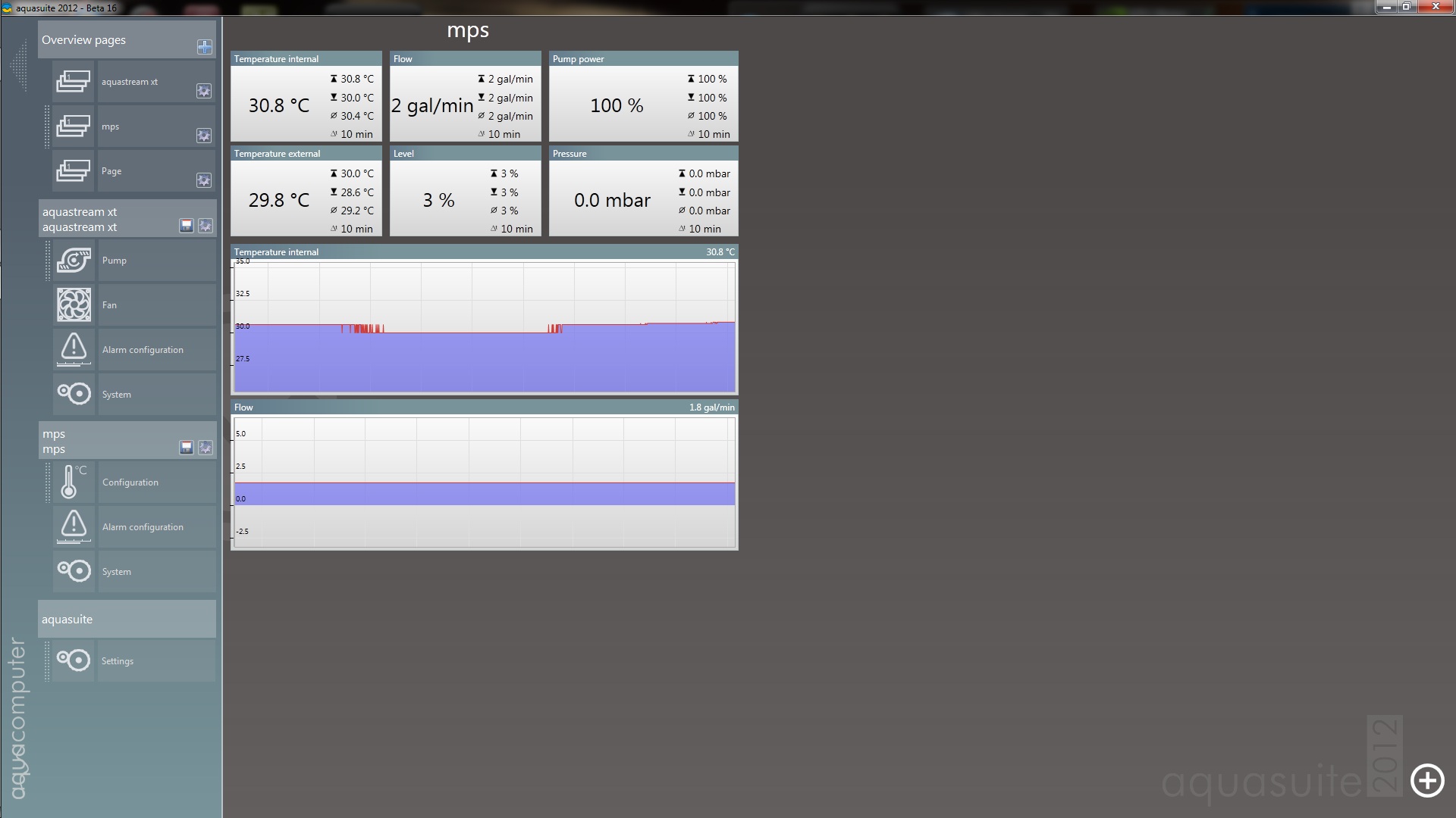

think i got it
mercredi 10 octobre 2012, 19:05
here is the overview page tell me if it dont look good enigmag or any buddy else.
mercredi 10 octobre 2012, 19:27
i do´t think 2gal/min is OK
it should between 0,1-0,6gal/min with theaquastream xt
