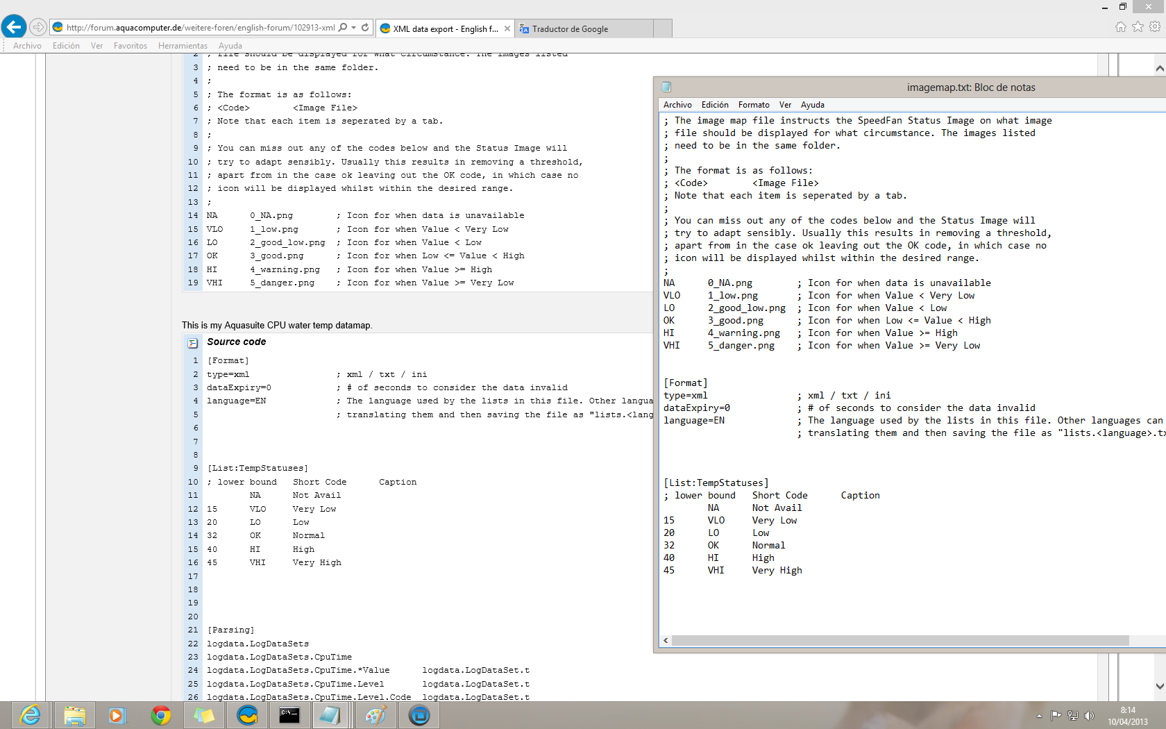

this is what I get. after restart. lcdhost
this is the test
novax1 a envoyé l’image suivante :
Phatboy69
mercredi 10 avril 2013, 08:24
You dont need to put the list temp data into the imagemap file.. the default file should work but you may need to add a missing shortcode in the imagemap. Just checked there is nothing missing in your imagemap but you need to delete the list data section incuding [Format] and below.
Ce message a été modifié 1 fois. Dernière modification effectuée par "Phatboy69" (10 avril 2013, 08:26)
I am Intel of Borg. Resistance is futile. You will be assimilated.
i7 3930K @5Ghz - X79 ASUS Rampage IV Extreme - 4x SLI GTX580 - 16GB DDR3-2000 - 4x GTX 360 rads 24x CM fans - Aquaero 5 XT +6 PA2 Ultras - 2 x Enermax 1500W PSU - MM Extended Ascension Case - 2 x 452x2 Res and 4 x D5 - 3 x 24" Acer H243H LCD
novax1
mercredi 10 avril 2013, 08:27
Please help me.
that code is.
do not
Phatboy69
mercredi 10 avril 2013, 08:28
Just use this imagemap file as is. dont change it and everything should just work!

novax1
mercredi 10 avril 2013, 08:34
and since the original code imagemap 14x14.
But the code.
Datamap temp. where I have to put
Phatboy69
mercredi 10 avril 2013, 08:46
This [List:TempStatuses] section and the 2 entries list:TempStatuses,2 & list:TempStatuses,1 need to be put into the datamap file your already using to collect Aquasuite sensor data.
These sections are new to enable the lookup of status codes.
Here is my datamap file with the changes I made to enable the lookup table. (list)

novax1
mercredi 10 avril 2013, 09:07
no. I'll be doing it wrong but still can show
Phatboy69
mercredi 10 avril 2013, 10:36
Not sure what your problem is....
Its picking up the right value for logdata.LogDataSets.CpuTemp.Level.Code logdata.LogDataSet.value list:TempStatuses,1
The value is working in the lookup table. Maybe check you have tab delimted the columns in the [List:TempStatuses] section and in your imagemap file also make sure the columns are tab delimited. (ie delete the space between each value on each row and the press tab between each value to create the delimit)
Also make sure you have the right paths set and that the imagemap file is in the same directory as the images. other than this you'll have to trouble shoot it on your own sorry!

novax1
jeudi 11 avril 2013, 17:06
Thank you for your help.
But after trying many combinations i change in the code, I can not show the images to the rpm. :wacko: :wacko: :wacko:
thank you very much
novax1
vendredi 12 avril 2013, 20:10
Hola
Sigo intentando poder mostrar los iconos de estatuses.
Pero no lo consigo.
He reiniciado, modificado, cerrar lcdhos y abrir y ya no sé qué puedo hacer.
Con los iconos de las temperaturas no he tenido problema.
Pero con los del rpm de flow y fan para aquastream xt . No muestra nada. :cursing:
Usted sabría si hay que modificar algo más aparte del datamap :?:
Hello
I keep trying to display the icons of statuses.
But I can not.
I've rebooted, changed, and open and close lcdhos do not know what I can do.
With temperatures icons I had no problem.
But with the flow and fan rpm for Aquastream xt. Nothing is showing.
You know if you change something besides the Datamap
Phatboy69
samedi 13 avril 2013, 01:45
I didnt change anything else.
I suggest checking the format of your map files and make sure all data fields are seperated by a tab and that there are no erroneous spaces.
From memory your imageviewer widget was returning the correct value from the datamap but the imagemap wasnt returning the correct image. I would also make sure all paths and directories are correct.
Ce message a été modifié 1 fois. Dernière modification effectuée par "Phatboy69" (13 avril 2013, 01:47)
