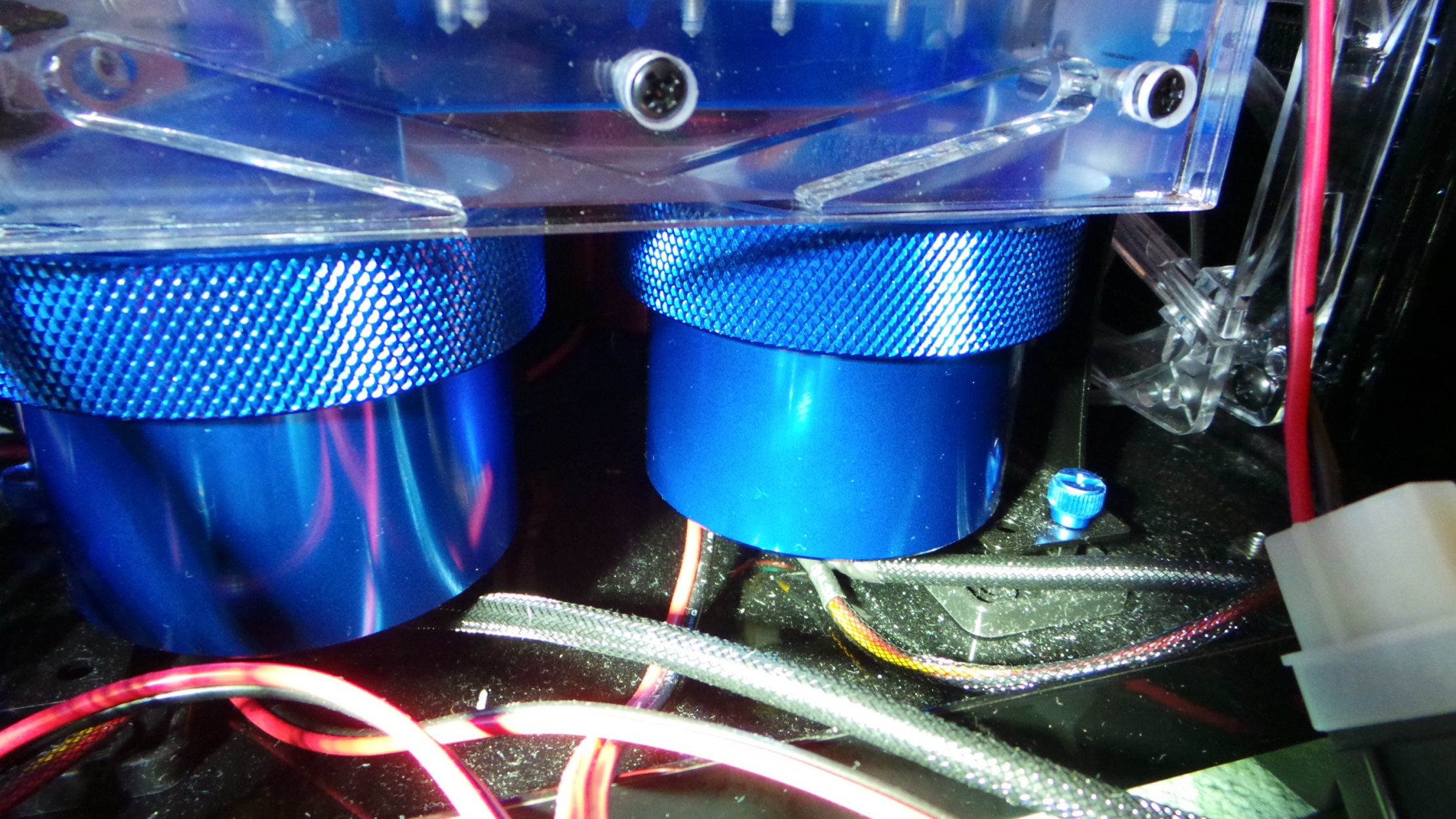

Not possible to photograph my pump setup in my computer case without A LOT of fiddling about to show you what I meant in my post above. Stating it a little more precisely, the Bitspower pump kit consists of several parts. The cylindrical housing which holds the pump onto the pump top looks like it is one single part in the picture you linked to but it is actually two. One part is the cylinder that screws onto the pump top to hold the pump in place. The other is a circular end cap (with the Bitspower logo) that simply fits inside the cylinder to hide the pump. You can use the pump kit without this end cap so the Aquacomputer mps D5 electrical connectors are free. (These pumps wouldn't fit with the end cap in place anyway.)

I also have these dual D5 pump mods and the aquacomputer D5 pumps.
There is no way you can leave the back plate on. It will work just fine without it.
Have a look at a few of my pics, it won't cause any problems.
I struggled to find a place to mount them in my case and I have 4 dual kits (8 pumps)
I ended up buying the pump top mod kits from frozen cpu here.... http://www.frozencpu.com/products/16074/…150AC-CLCL.html
Check the last few pics to see the dual version.
I bought them as they raise the pump off the ground which enables access to the ports on the bottom of the pumps.
I used motherboard standoff screws to raise them higher as I still couldn't gain access.
Hope you get to where you want to go.
