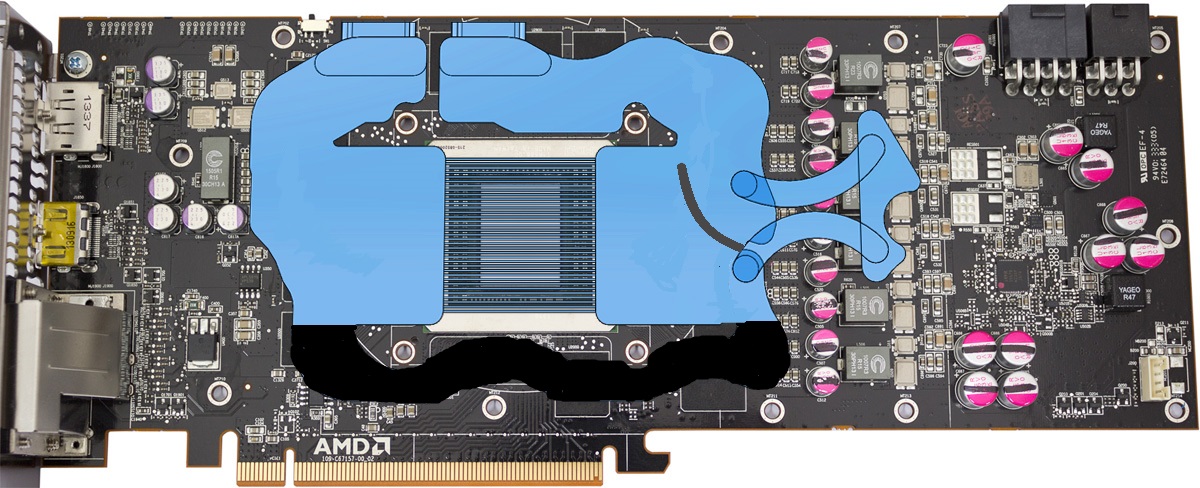

These blocks seem to be overly restrictive over the gpu area, causing the coolant to travel in what looks like a secondary channel for the VRAM chips on the bottom. I've never seen another AC block designed this way, I have not taken off the faceplate to verify this but it looks like virtually none of the coolant will run over the gpu.

In my opinion it could be quite possible due to low flow rate or pressure in the whole system - many components with high resistance and just one pump - that the water takes the path of lesser resistance, in this case through the lower channel to the voltage converters. I can imagine, that the thin grooves that are meant to be flowed round over the GPU spot have a much higher resistance, as that small lower channel if we keep in mind that low water pressure or flow rate. Maybe a constructional flaw? But I can't believe, that it was not thoroughly tested.

I only can think that you get a higher resistance because of turbulences when the water 'tries' to get through the fins. The fins at the beginning are not round or aquadynamic and the resulting little turbulences blocking the flow through the fins and the result is a higher resistance. The restistance through the smaller lower channel seems to be lower and the water flows that way. I guess it's much more distinctive if you have low water pressure or flow rate.
You must consider, that your old water blocks didn't have that detour to the voltage converters.
Did you try to max. the RPM of your pump yet? Perhaps a higher flow rate leads to a better flow through the fins and grooves?

Designed which way? These turbulences occur naturally even on water blocks from other manufacturers with an equal fin/groove design. The only difference is that detour channel. Aqua Computer is the only manufacturer with that design and perhaps that's the reason why your temperature of your GPU is so high. Lesser cooling, because the water takes the detour instead of flowing over the GPU spot. Without the detour channel the water will be forced to flow through the fins and grooves of the GPU spot alone.

The Original design looks like this...
In my opinion, it would be a better design to push the water through the fins and gropves of the GPU spot first and only then force the water to take a detour to the voltage converters. I think the GPU has the highest priority to be cooled...the voltage converters are second and the RAM is third.
Something like this...
