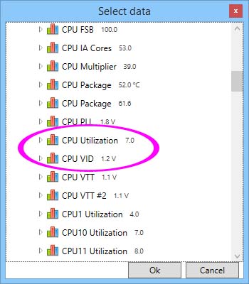

Possible anomoly when using a WMI source
mardi 6 janvier 2015, 14:45
I am playing with aquasuite to learn it, and when using a WMI source, it appears the title at the bottom of the gauge is formatted incorrectly.
This was noticed with versions 2015/2 & 2015/3. See CPU Utilization gauge bottom center of attachment.

Regarding my post 27 above, I found that any value taken from WMI that has a label (v, rpm, °C) attached, formats properly. But without a label attached, the formating fails.
mardi 13 janvier 2015, 13:50
Working under the assumption Aida64 was not providing the units/labels for all the values sent to WMI, I suggested it would be useful if Aida64 did so in their forum.
The reply was "AIDA64 exports both units and values for all type of readings It's the fault of the other (importing) software if it only picks up some of the units. Or, in this case, I suppose Aquasuite assigns units based on type of values, and doesn't use the units provided by AIDA64 through WMI.".
Is it possible there are varying interpretations/implementations of the WMI specification, particularly in passing unit values?
mercredi 14 janvier 2015, 13:25
I have checked the aida export via WMI.
Temperature and voltage sources has a Unit (°C and V), other sources like CPU Load has only a "S" as data type. We cant attach a unit to this value.
When no Unit is provided, we have actual a problem with the formated output of gauge values/descriptions in the element.
This bug is fixed in the next version.
