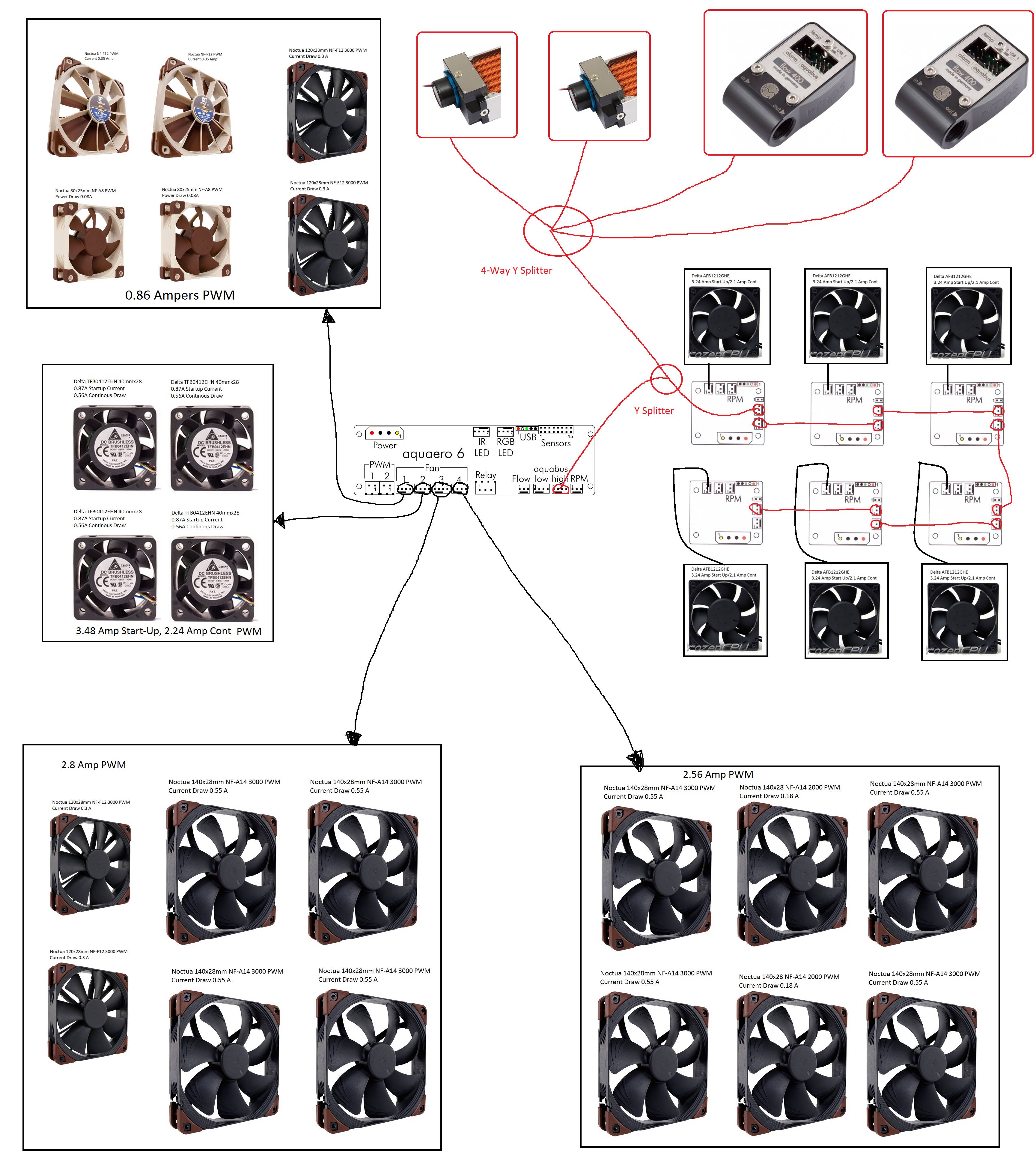

Bytales
dimanche 18 janvier 2015, 12:47
Here is how i plan to wire everything up. I hope you can see it good since the resolution of the file is pretty big.
1)The question that is to be raised is the following.
I quote from AquaAero 6 Manual
Maximum current is 2.5 A per output independent of output voltage, resulting in a maximum power of 30 W at 12 V. Outputs will be switched of if amplifier temperatures reach a critical level and will automatically be reactivated when cooled down. If an output current of 3 A is exceeded, the out put will be permanently disabled.
My AquaAero has the red HeatSink, and also the watercooling block.
As you can see from my diagram i have some fans groups that are exceeding 2.5Amp together. I suppose they will work, since it is no more than 3 Amp and the AquaAero is properly cooled.
But the small 40mm Delta Fans have an initial Current Draw of more than 3 Amp, allthough they are sucking continuosly less then 2.5 Amps
Will it work or not ?
2)The other question is if the Aquabus wiring i showed in the picture will work with the devices i plan to wire this way, or should i strive to connect them somehow through USB ?
Only the AquaAero will connect to Motherboard USB.
Also i want to say that i am planning to do the splitting using Wago Connectors.

avictord
lundi 19 janvier 2015, 01:26
Hi Bytales,
The Delta fans selected are extreme end are they really necessary. Do you require the CFM? If you rationalize the fans and exchange these Deltas for a lower Amp fan you can reduce the number of PAs.
Bytales
lundi 19 janvier 2015, 12:04
Yes, they are extreme, yes i could reduce them, and the PA, but i allready got six PAs mounted, and i gotta fille em up with something that can proper load them. Besides, i want to hold the GM Titans under load at 25 Degrees.
Thats why its called Project Fill it UP.
The question that remains is whether the 4 smal Delta 40mm fans will be ok on a single Aquaero chanell.
And if the displayed Aquabus Splitting will work as intended. Or should i try to connect them through a USb hub ?
lundi 19 janvier 2015, 13:51
Aquabus is ok, you only need to connect the PA´s and MPS´s once on usb to set the Aquabusaddress and Update the firmware.
If the Delta 40mm to much you can combine two of the PWM and connect there Powersupply directly to the power-supply unit.
Bytales
lundi 19 janvier 2015, 17:17
You can always connect fans to power Supply. But the whole point was to have it wired through AquaAero. Probably im going to have to look for some other fans, as the manual states that if the Amperage draw is more than 3 per Chanell it will shut off.
So the 2-Way Y and 4-Way Y Connection of the Aquabus as drawn will indeed work. Its good to know. Im still trying to figure out how i am going to wire 11 pieces of equipement on USB inside the case.
lundi 19 janvier 2015, 18:08
No, i mine get the PWM Signal from the AquaAero and 12Volt and Mass from the power Supply, then the only limit is the PWM Signal strength.
Citation
It is a parallelbus, you put all parallel and it is ok, the PA´s are a line but the parallel wire, too.
Bytales
lundi 19 janvier 2015, 20:48
Citation
Hmmm, i didnt thought of that !!!
Since the fan port on Aquaero 6 are all PWM, one could get away with connecting the power of the Fans to the PSU, and the PWM signal cable to the AquaAero, then it wouldnt draw power through the Fan Port of the AquaAero. Ahahahahaha, then you could connect higher power fans that exceed 3 Amp together directly to the PSU, and only the PWM signal cable to the AquaAero.
OMFG, why coulndt i have though of it in the first place. Now i can use the Delta Fans without a problem and for the last group all 3000 PWM fans, yupiii !
