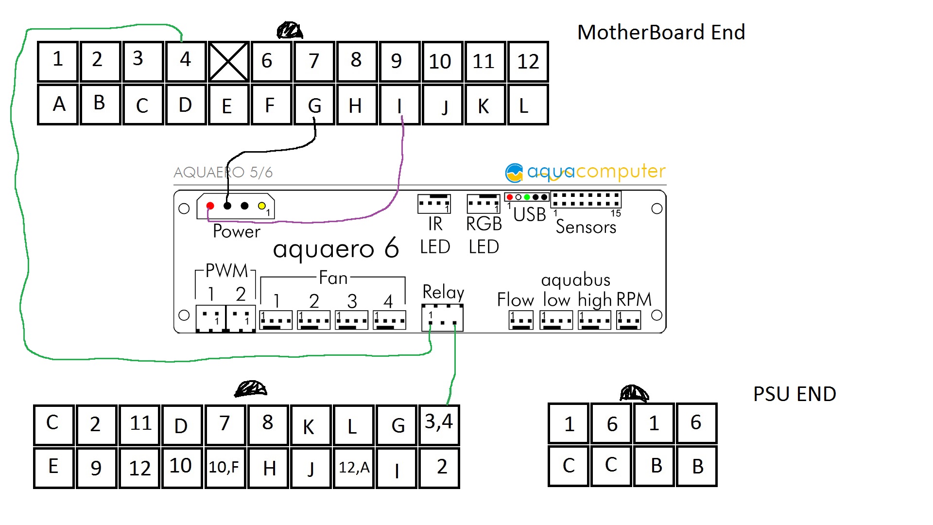

If you need StandBy-Power at rock bottom Power-on-level (I do´t knowe why) you have to connect the purple wire too on of the red dots and the black to the black (Power or Usb), apart from that do´t connect the 2 Pin.
I do not need Stand By Power, I believe AquaAero doesnt need Stand By power, i believe it is somehow always on. But i could wire it to get Stand By Power as well, since i am building my own wires.
I want to ask you the following. Before i burn everything due to false wiring i noticed that on the Aquaero 6 Skema, you connected the green wire to Slot 1 and 3, of the relay connector, whereas on the Aquaero 5 Skema you connected the green wire to Slot 1 and 2 of the relay connector. Doesnt it matter to which slot on the connector the green wire goes ?
Should i understand that for this feature to work one has to wire only the green wire ?
So the Stand By Power if I were to connect it comes like this, together with how you depicted the Connection using the Aquaero 6 Board would be like this, notice the Motherboard End and the PSU end of the connectors (i believe that does not matter, doesnt it ? i mean from which side come the green cable in which slot of the relay):
If you have USB Stand By Power it is enough, AC have left out the connector on the AE6 because is no longer needful with Stand By Power on every USB
NO, it do not matter, but its 2 and 3 at the AE5
If the green wire is connected to mass (the motherboard make the connection when the power-button is pest and separate the power-button is pest again), the PSU is on. You cut the green wire, no mass, no power.

Ok, so if on AquaAero 6 it is not needed, i'll leave it so. And the green wire goes to 1 and 3 on the Aquaero 6.
The "Cutting" is done within the AquaAero 6, it does the cutting, right ?
And as it is connected on 1 and 3 the PC will have power, right ?
The manual doesnt state "mass", it states like this:
Pin 1: normally connected
Pin 2: normally open
Pin 3: common connector.
So green wire from PSU-Connector end goes to Pin 3 (common connector)
ANd green wire from Motherboard END Connector goes to Pin 1 (normally connected), and in this Configuration the PC should power.
If the AquaAero decides to cut the power, and the wires remain connected as they are (nobody plugs the wire, they remain as they are), when i start the PC fresh, will it start ?
samedi 31 janvier 2015, 13:30
Yes.
You have to tell the AquaAero when he should cut the power and how long (10 sec by enough there is a jog switch(Selbsthaltung) on the Motherboard, when it is broken the power stays out till next power on)
