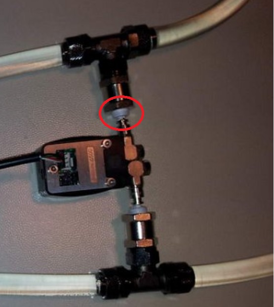

I found i guide on the net about the installation of the delta 100 as a filling sensor... "this tube is then connected to the “LOW” marked port of the sensor…. THIS TUBE MUST NOT CONTAIN ANY FLUID IT MUST JUST BE FILLED WITH AIR!!!!...."
And an istallation of a delta 500 as a sensor of pressur drop measure and probably i misinterpreted the image.

mercredi 13 mai 2015, 12:46
The Pressure Equalization Membrane is a replacement for the low pressure tube by using atmosphere as the tube.
A good explanation can be found in section 6.3 and 6.4 of the MPS manual.
