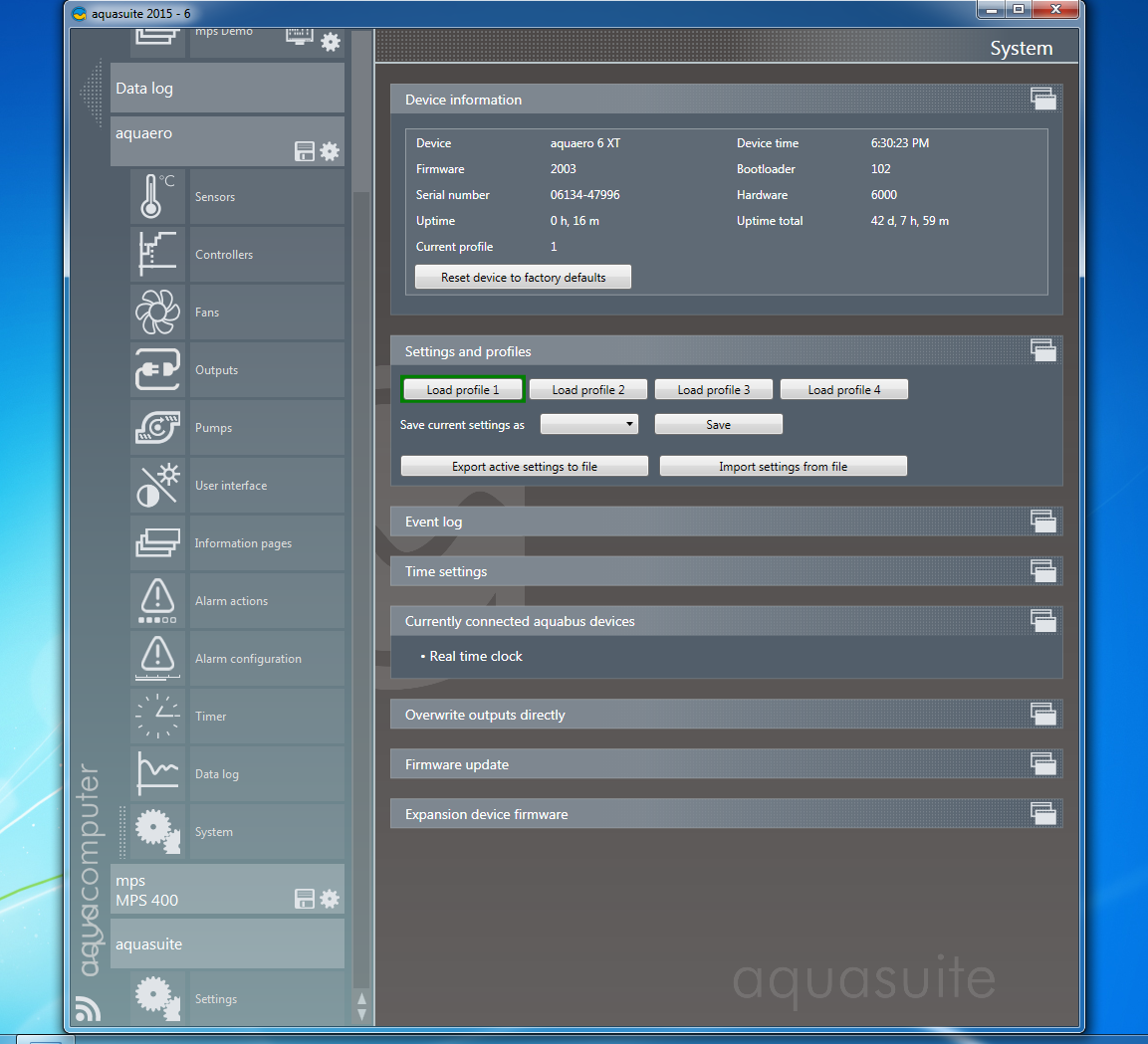

OK , here is the photo for what I am talking about
as you can see the Aquaero didn't detect the MPS 400 and shows "Real time clock" ! Is that a Joke !!!???
And more then 80 people look at this post and none could help !

[attach]5324[/attach]OK , here is the photo for what I am talking about
Please don't shout at us, we will do our best.
The real time clock in the MPS list is not a joke. You must have a Real Time Clock installed, and since it communicates via the aquabus, it is listed under aquabus devices.
The problem is that none of your other devices show up in the aquabus list, so the aquaero does not see them.
Since we can see 4 MPS devices in aquasuite, we know you have them connected via USB to the motherboard.

Yes both USB and Aquabus cable are connected and none of them shows in Aquaero
And I don't have that "Real time clock" install and I don't know why it shows up ?(

The real time clock displaying in the currently connected aquabus list happens sometimes when you have an address clash. Ensuring each mps device has a unique address from 12 to 15 then removing all power from the aquaero, including USB standby power will fix it.
