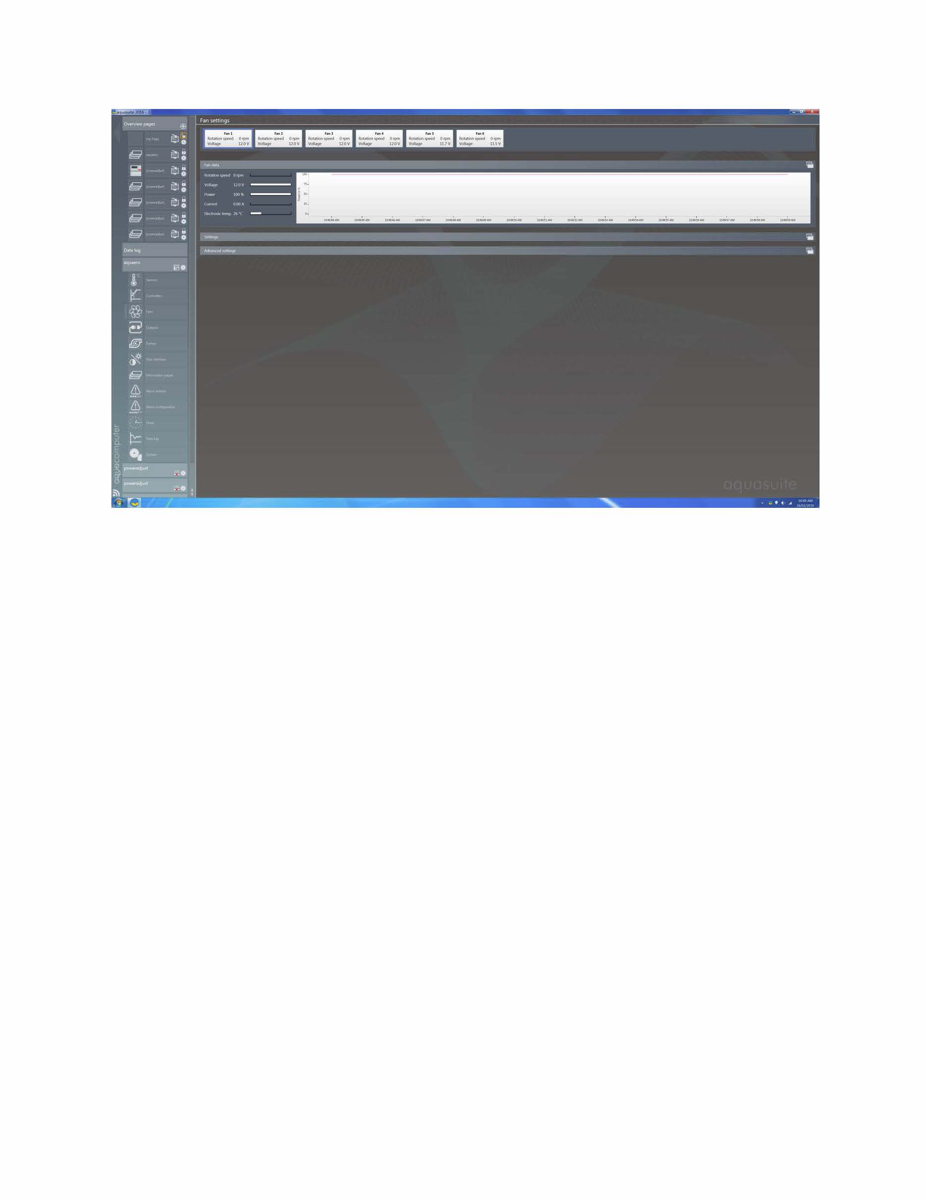

OK here are attachments, that's the only way I could upload them. I have try saving settings but no go.
This is by far the longest I ever spend on trying to configuring either software or hardware on my PC :(

Spoke to soon :( It does work, but only 1 PA3 module at a time and ONLY If I use 4-pin cable to connect directly PA3 with Aquaeros high speed bus, than strangely if I try to daisy chain first PA3 to the second PA3 module using 3 pin cable that came with PA3, both modules disappear from aquasuite, yes they both were assign different ID while they were connected via-USB

I still don't think your address assignments have been changed. Please plug in all three via usb only if you can and show the address assignments for each. If you can't do all three, one by one is ok.
The image above has the default address. Don't know if that's what it's supposed to be but I want to see the change.

The image I posted was when PA3 was connected via USB before I discovered that the only way I can see PA3 under devices connected via aquabus when I would use 4pin cable .Now when I use 4pin cable to connect directly the first PA3 to aquaero it works, but now if I connect 3pin cable that is connected with the first PA3 (daisy chain) to the second PA3 they both get disconnected.
They both have different ID's that I have assign while they were connected via-USB I can only do 1 at a time I don't have a slitter, but afterwords if I use that 4 pin cable and connect each of those 2 PA3 individually, they show under devices connected via aquabus and they have different ID ...50 and 51 I can make screens of it but that's exactly how it looks, something strange when I try to daisy chain them

I hope you can see the images and what they represent I have named them. Basically If I use 4pin cable directly to PA3 from aquaero it works as showing and it shows different ID from the other PA3 under devices.
If I use the 4pin cable to connect to splitter and than connect PA3 to that splitter with 3pin cable its not showing, if I connect 4pin cable again directly to the PA3 and try to daisy chain from that PA3 with supplied or my own 3pin cable them they are not showing at all.
