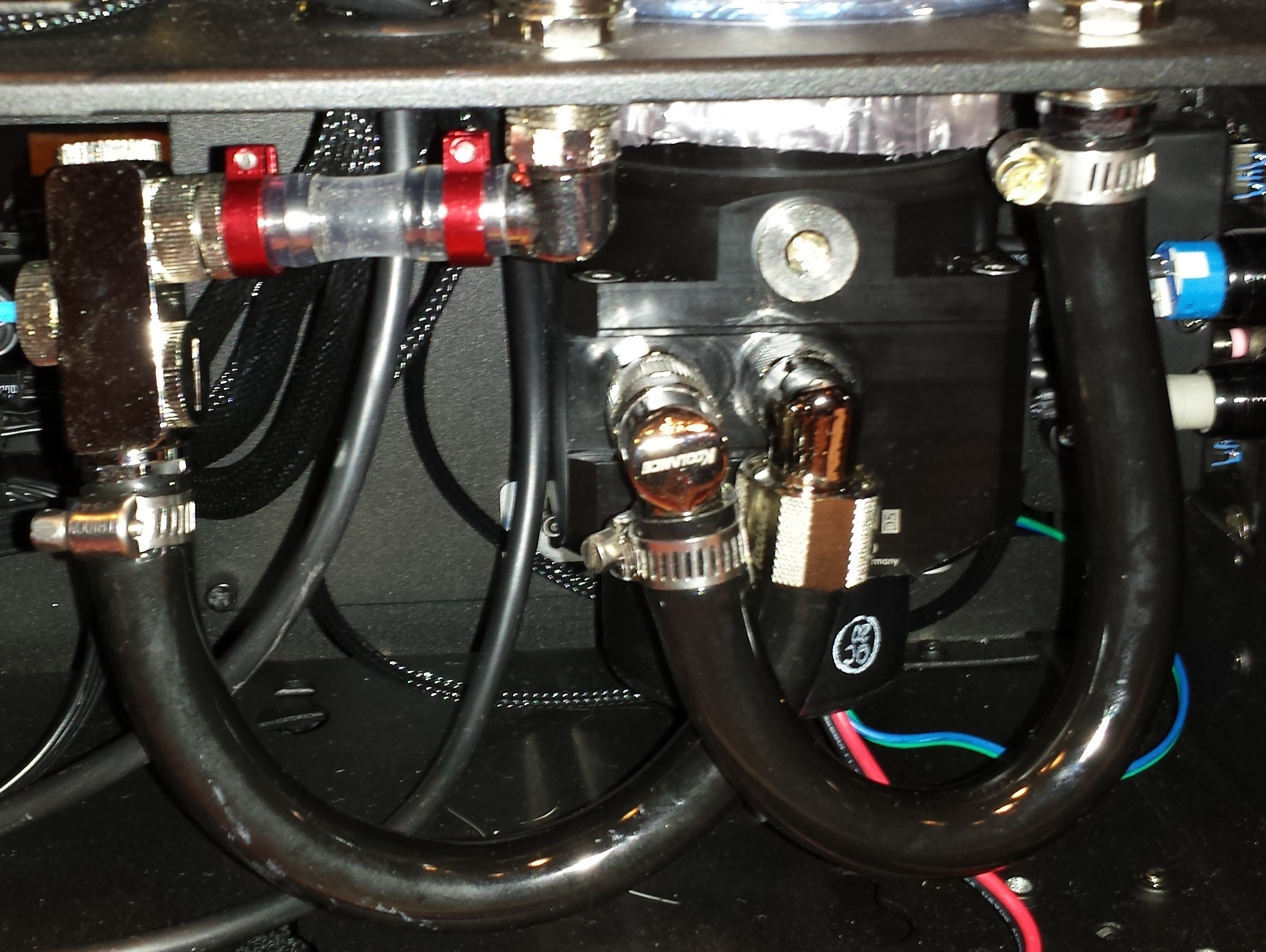

Hey guys, I just hooked in the above reservoir with the D5 pump adapter. Pressure tested and tightened up where needed, filled the res with Aq coolant, clipped in an ATX jumper to just test the loop with no MB or anything in the case and no Fountain? Pump is running, and I followed the instructions included... I think. (A picture would have been very helpful).
Is this connected incorrectly? picture attached.

NVM - I found some help in the Forums. Had to switch the inlet. :)

For others: the centered port must be used as inlet to get the fountain effect.
