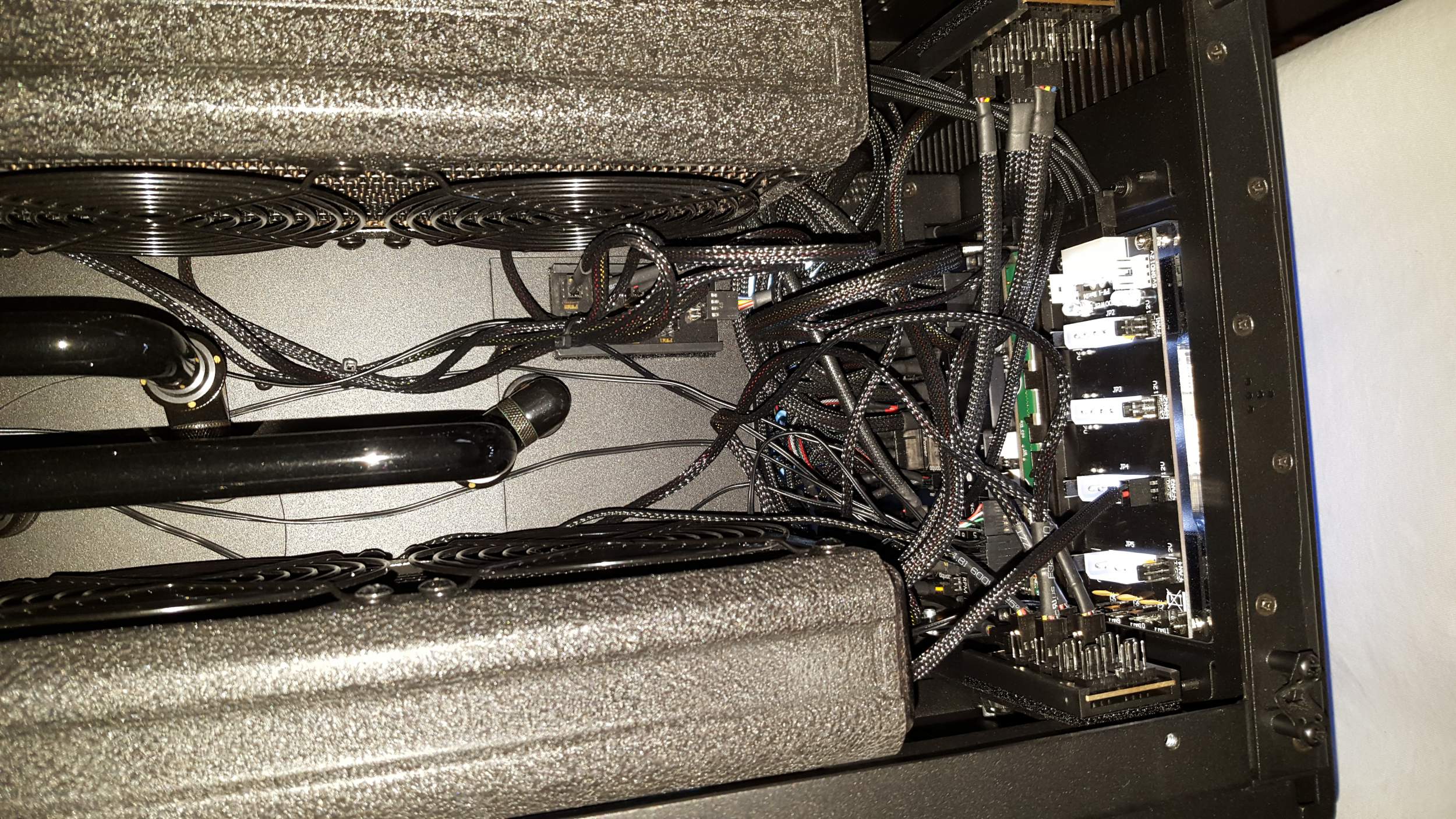

The USB connection has stopped working on all my devices (Aquaero 6xt, Aquastream, Farbwerk and sensors). The connection to the Aquaero 6xt did work, also together with Farbwerk. Disconnected all and got Aquastream (one at a time), also together with Aquaero. I connected the fill level sensor, it didn't work. Then things started to happen. First, the calibration on water temp on the Aquastream started to adjust itself upwards to max, no matter if I tried to adjust it diwn again, it also connected and dissconnected all the time. After a shutdown (dissconnected power), I couldn't connect to anything anymore. The USB works fine on other stuff, so guessing that it's ok, will check another connection later, if I don't get a solution here.

Seems like the NZXT UI01 USB hub is unstable. I got everything back and working after reinstalling Aquasuite, but the USB connections to Aquaero and Farbwerk falls out for a few seconds every now and again. Haven't checked the card reader that is connected to the same USB hub, will do that later.
Right now I'm running a system test. 4.4GHz, Intel 5960x and Asus RVE. CPU doesn't go above 65C, the water is below 37C and the radiator cools it 6C, after 30 mins test. I'm desperate, I don't need any of the Aquacomputer stuff since the system still runs on idle (both pumps at 3000rpm and all fans at lowest level, except the exhaust). :'(

Too few ports. Have you ever tried to use a 4-port PCB? The cables will not be shielded, but that shouldn't be much of a problem for Aquacomputer hardware? I have set up one, with connection from the USB hub, but I only got Aquaero and Farbwerk to work. Didn't test it very much since it was so much else to test.

Tested some of the cables and found that all, except the splitter to the Aquastream worked. But, taking one output from the USB hub, connecting it to a PCB and connecting more than 2 AQ products will not work. So, it's probably the current. I guess AQ products draws too much current for only 1 USB port to handle more than 2 of them? Do you have a suggestion as to how to connect power to a PCB board?

I think the name is NZXT UI01. Yes, it gets 5v from a PCB next to it that I use for 12v and 5v (have to think straight when connecting the cables hehe). Other equipment connected directly to the hub gets power enough (my mobile among other things). I have 2 of them, but one is unstable for some reason and I don't have a 10-pin to 10-pin cable that I can use to connect them (and missing the power cable to one as well). I'd really want a hub with enough internal USB-ports, this one only has 3 x 10-pin outputs and I have to use 2 full 10-pins to the card reader, leaving me only 2 that I can connect to AQ stuff. I guess I just have to let the cables hang loose and connect them one at a time, as I need them.
