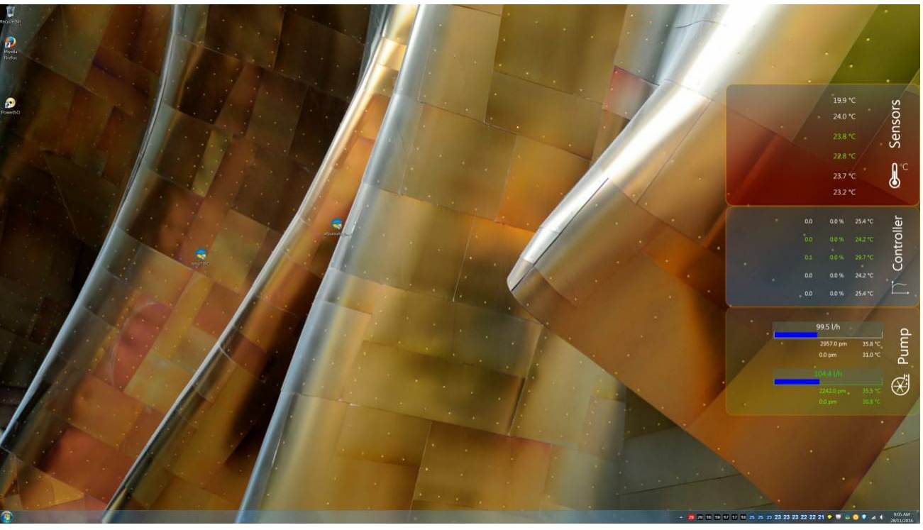

Dundys
lundi 28 novembre 2016, 15:36
After updating with new (fixed) 2017-1.1 still missing items on page

Dundys
lundi 28 novembre 2016, 17:10
Citation
Its all good now
