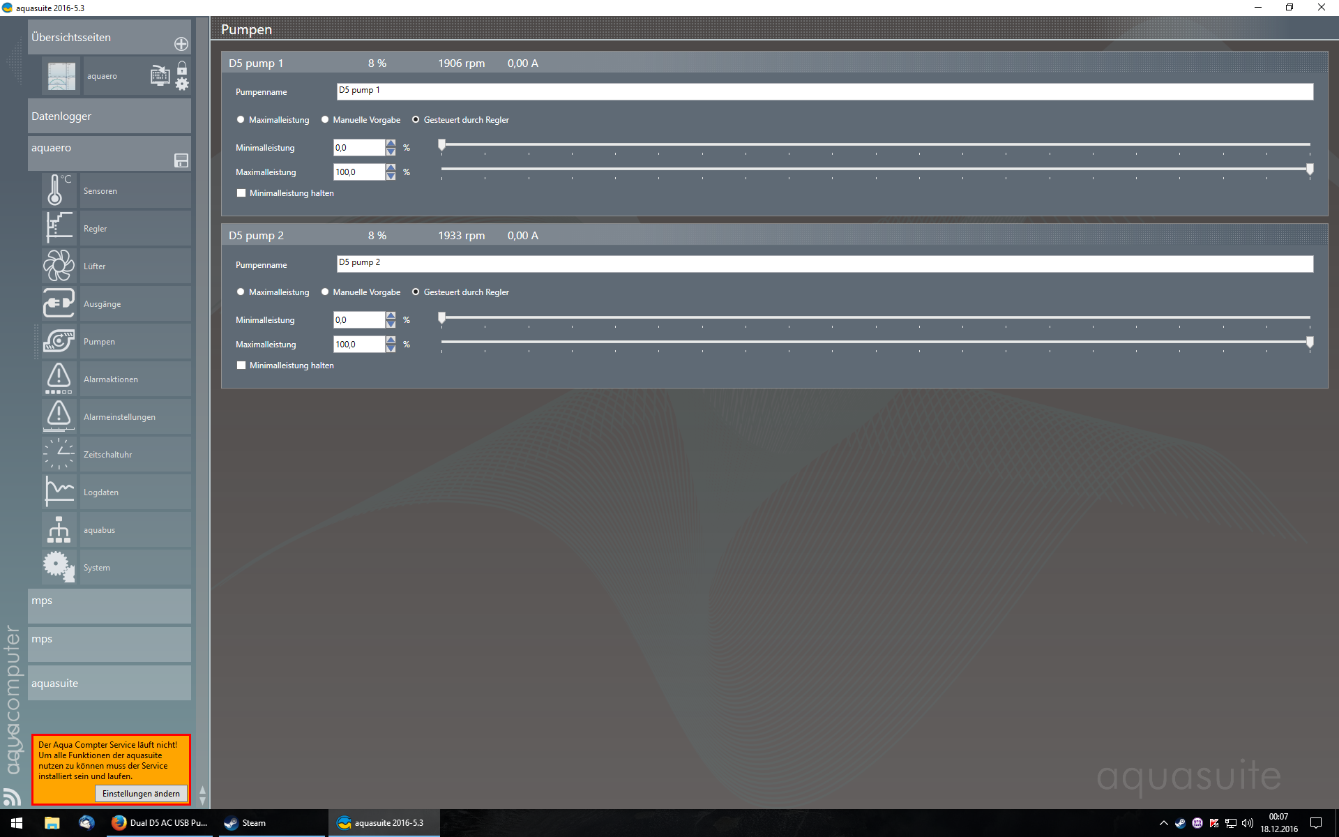

I am running 2 AC D5 USB pumps in serial with an EK pump top. I have managed to get both pumps to show up in aquasuite and connected to the aquaero via the aquabus only (connected by USB first to assign different bus addresses). Both pumps can be controlled in aquasuite but only 1 of the pumps is reporting information - rpm,Hz, A and %. Any ideas why the other pump is not showing this?

Screenshot below:
dimanche 18 décembre 2016, 00:11
No idea, my AE5lt is fine
PS: The AS2017 seems to be slightly different from the 2016
PPS: Have you checked molex power to the second pump, the pins are sometimes pushed backwards out of the plug
EnigmaG a envoyé l’image suivante :
