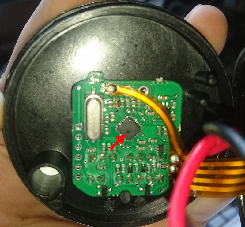

I opened the pump circuitry, and the flex cable connecting the two circuit boards had come loose on one of the solder points corresponding to USB ground (black cable on USB).
I then resoldered the connection and tried again. No luck, same problem.
Is the pump a goner? Or do I have any components missing?
I took some pictures of the circuitry, there appears to be a bare pad for a capacitor, but I have seen from other posts that this is common.
https://imgur.com/a/MoM1p

Please take a closer look at this black dot on the CPU. Maybe it is just some kind of dirt but it could also indicate that the CPU is burned which might also explain why the pump does not work.
IRN
mardi 3 octobre 2017, 19:23
I rubbed it to check if it was dirt, it seems it is the plastic itself.
Here is a closeup picture
https://imgur.com/a/UyyfI
I guess it is beyond repair then, too bad :/
mercredi 4 octobre 2017, 16:50
Hard to tell from the photo but it looks a bit like the CPU is burned. If so it must have happened for a reason. Maybe you have changed something on your PC lately - especially the wiring?
The little controller board in the cover can be replaced for a reasonable price but the more interesting question is if the controller board in the pump is still OK because this one can not be replaced.
