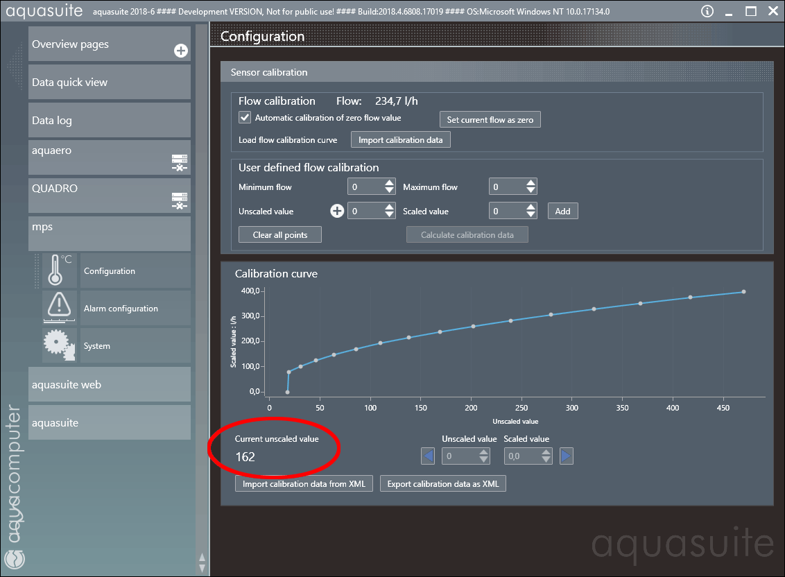

Below the diagram you have an unscaled sensor value. What does it say?
Panzerscope
mardi 4 septembre 2018, 11:43
Thanks for your reply. It is showing 0 for Unscaled. For clarity I have included screenshots of what I am seeing.
mardi 4 septembre 2018, 11:49
I meant this one:

[attach]6520[/attach]
Looks like my second attachment did not come through properly. However my ''Current Unscaled Value'' is 0
Thanks.
