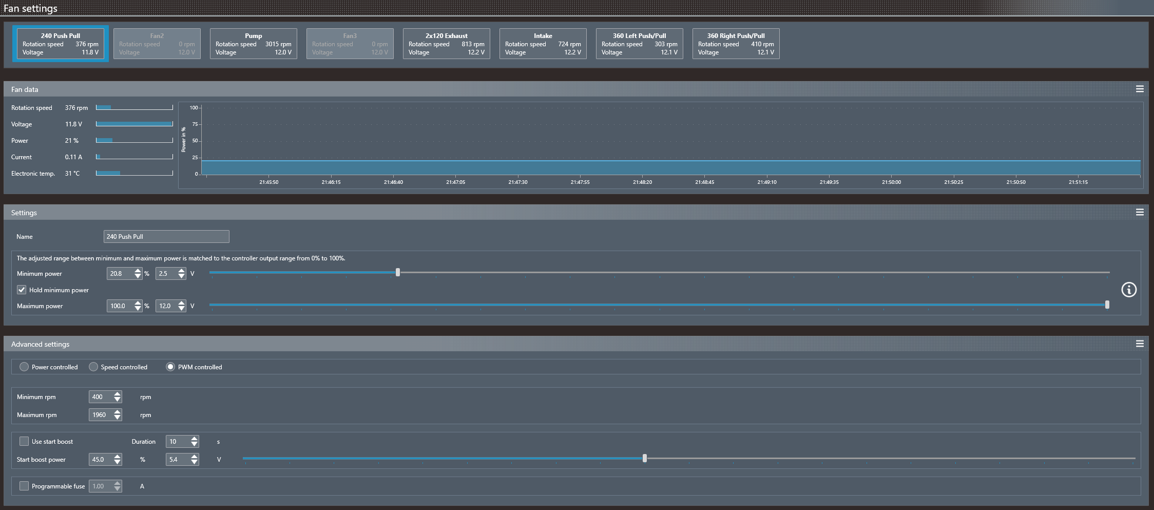

The reason you are experiencing this is because the minimum PWM value for the pump is set to 0%. Usually the pump works in full speed when the PWM is set to 0%.
To counteract this, go to FANS, and set the minimum PWM value for the Pump output to, lets say, 30% and check Keep minimum value (or something). This way the Pump will be at 30% while the PID Controller is at 0%.
Doh, that makes perfect sense. I knew this behavior about the pump, I should have thought of that.
Have you actually gotten this to work? I've never tried to set minimum speeds for the pump, but I have for the fans, and it just does not work. I go in to the fans page, set them to PWM controlled, and it gives me th eoption to se min and max RPM's (not duty cycle percent) but when I set those values it simply ignores them, and goes below the min and above the max anyway. Maybe there is something I am missing.

I guess I just need to figure out why my minimum speed limits are not working for my PWM fans and pump. I tried the set points on my fans as well, but it kept dropping the fan speeds so low that they shut off (I use Noctua iPPC-2000 PWM fans and that's how they behave). This resulted in a wild oscillation between off and 100% fan speed. I tried to limit them to a minimum of 450rpm (where they are completely silent to my ears) in the fan setup screen, but as mentioned before this does not seem to have any effect at all. Even with th e450 minimum set, the setpoint controller still allows them to drop to 0 and turn off.
Anyway, appreciate the feedback! Please let me know if you have any thoughts regarding my minimum speed issue.
I'm going to try it again when I get home, and post screenshots if I can't figure it out.

The min max RPM setting is only for Speed Controlled fans option not PWM option.
Ce message a été modifié 2 fois. Dernière modification effectuée par "vvv850" (25 avril 2019, 20:59)

I have been able to get the minimum speed controls to work now. I think what was throwing me off was that it said "power" and the voltage field changed when I changed the percentage. I didin't think this applied to me since I am all PWM.
Now that I have both minimum pump and fan speeds set, the set point control actually appears to work.
