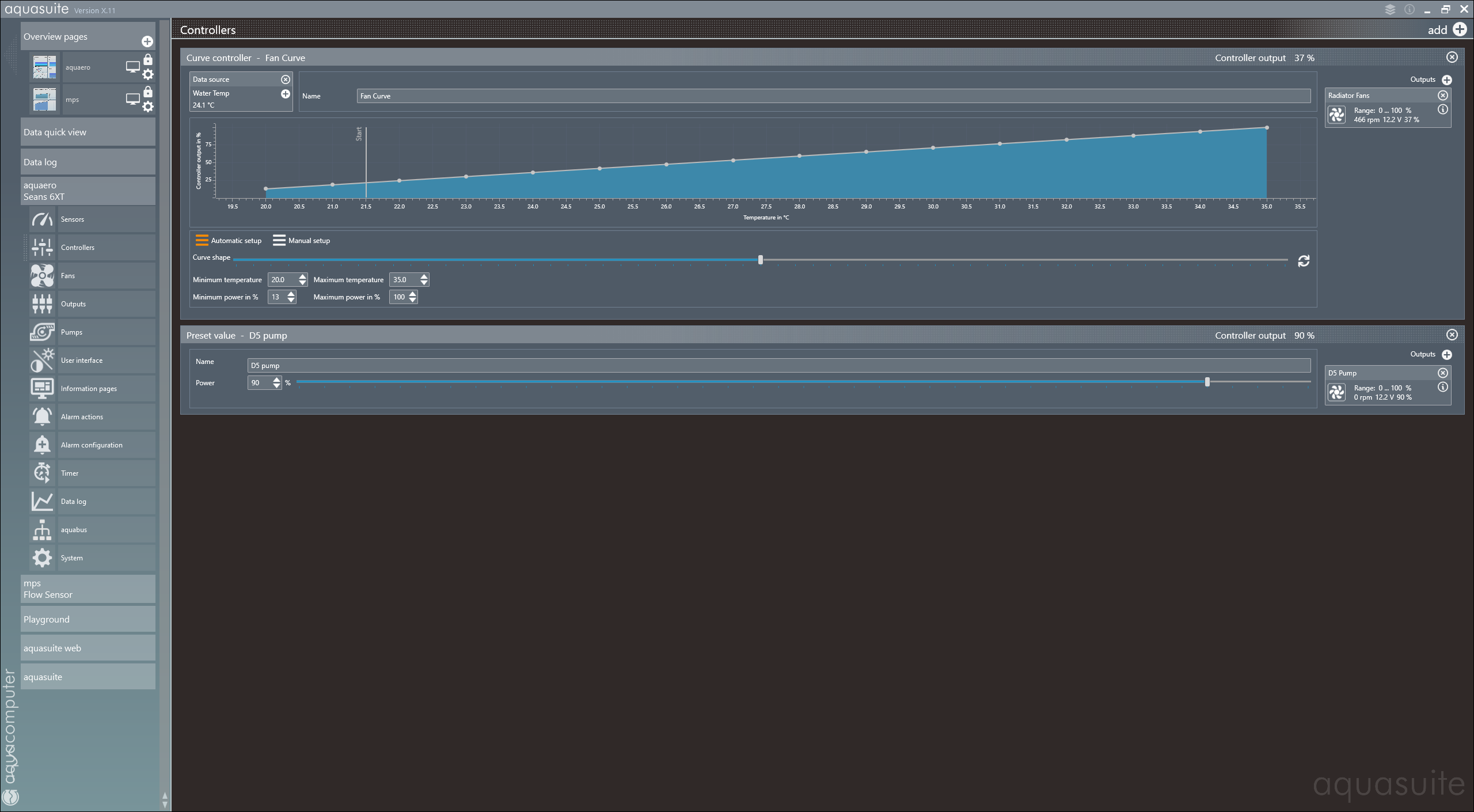

For the Pump issue, PWM pumps like the D5 that I run need to be connected to 1 of the available fan channels and then setup in the software just like a fan, Once you do this you can make a Curve controller just like you would if it were a fan.
Since you have 2 pumps you can connect them to a splitter on 1 channel and control both as a single pump or you can run them on separate fan channels if you want individual control.
Included are 2 screenshots of how my D5 PWM is setup as a fan. I currently am only using a set point controller but you can set a curve controller if you'd like.
sultan.of.swing a envoyé les images :

Most people set there pumps to one speed and leave it, setting them up on a fan curve can have them ramping up and down. I set my 2 D5's on one fan channel, setup as a preset fan. I set my speed to give me about 230lt an hr, which is just over 1 US gallon a min.
+1 I do the same.
