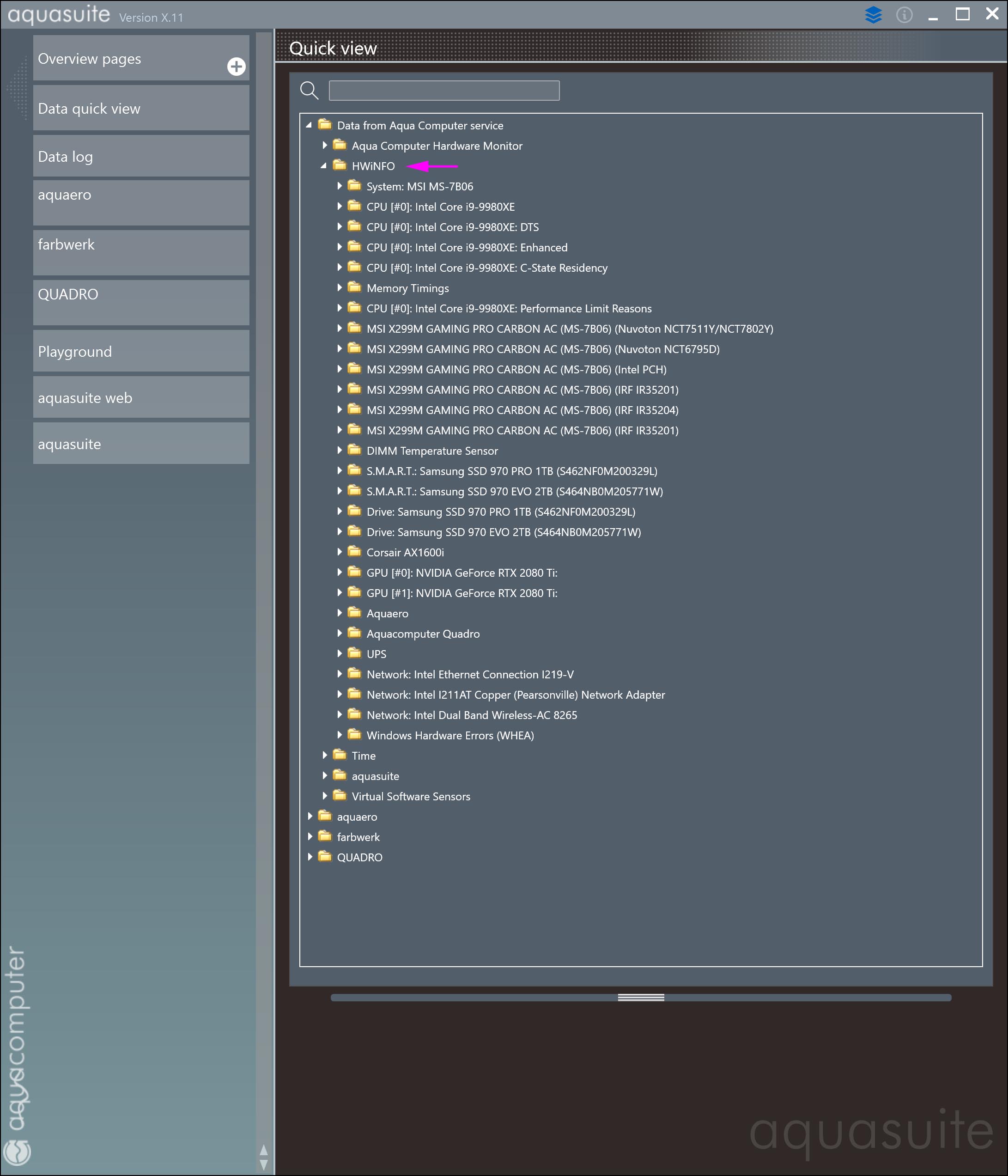

The aquasuite is able to see all sensors HWiNFO picks up.
The aquasuite also has some basic system sensors included,, which it can pickup without 3rd party software.
