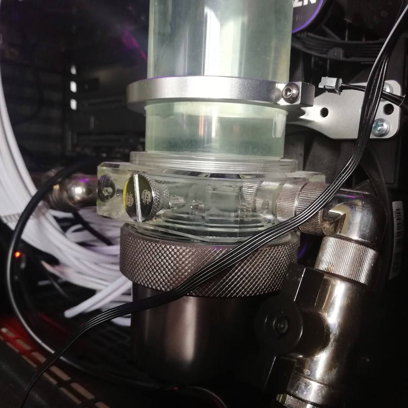

Thanks a lot! :) I cant exchange it, but I can buy another one and use this one for that other function. I was wondering, can I install that fitting for the lowest part of the reservoir to the side of the D5 top?
Maki911 a envoyé le fichier suivant :
  • IMG_20200217_103245.jpg (283,71 kB - téléchargé 430 fois - Dernier téléchargement : 22 septembre 2026, 15:19)
lundi 17 février 2020, 15:04
Where does that port lead?
If it has a direct path to the bottom of the reservoir without influence from the pump's rotor, then I would think so.
But if it is an alternate discharge port, then no, because the output pressure of the pump would bias the pressure sensor and yield results not related to the water column's height.

Nope, pump is literally the bottom of this reservoir and that opening is at the side of D5 top...
mardi 18 février 2020, 05:06
Which pump top/rez combo is that?
Maki911
samedi 22 février 2020, 23:49
Singularity Computer combo on D5 NEXT Pumps....
dimanche 23 février 2020, 05:45
If THIS is the pump, then looking at one of the images, it appears you have 3 inlet ports and one discharge port.
If this is what you have, then you could connect the pressure sensor high side to any of the 3 inlet G1/4 ports on the pump top with good results. If there is a bias from the fluid flowing past those ports into the center of the pump, it should be minimal and constant. I assume the important function of the sensor is to indicate change over time, not absolute accuracy.
