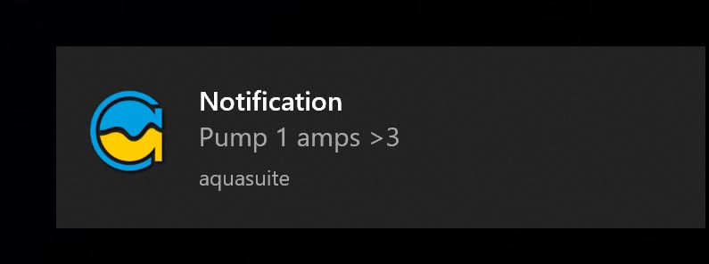

lundi 12 octobre 2020, 05:03
Is it possible to add a software sensor and trigger an alarm based off of the pump Amp current draw?
I believe the alarms in the aquaero can only be triggered by fan amp temps or fan rpm.
But you can setup a 'Notification' to trigger Windows Notification service for over-amp condition of the pump. (notification_setup.jpg)
You would use the 'Current' value of the fan port the pump is connected to. (notification_source.jpg)
Then Windows will display a Notification when an over-amp status is experienced. (notification.jpg)
Edit: you stated you had no speed control, so I assume the RPM signal is not connected. If you have an RPM signal going to your fan port 4, you can do an alarm for low RPM.

Tanquen
mercredi 14 octobre 2020, 01:37
But you can setup a 'Notification' to trigger Windows Notification service for over-amp condition of the pump. ([attach]7765[/attach])
You would use the 'Current' value of the fan port the pump is connected to. ([attach]7766[/attach])
Then Windows will display a Notification when an over-amp status is experienced. ([attach]7768[/attach])
How do you post pics?
I setup a notification on current but used the less than as I want an alarm when the pump is not running and like less than 1 amp.
You can only get this warning if Aquasuite is running?
No speed read either. :(

mercredi 14 octobre 2020, 15:11
Two ways to post pics:
  • click on the 'Insert Image' icon on the toolbar of the post you are making
    this requires the pic to be on the web and will insert it via an URL
    the picture will display in the post
  • click on the 'Attachments' link at the bottom of the post
    this method uploads a picture from your computer
    you can then insert a link to the uploaded picture in your post
Citation
Yes, the aquauite must be running for the Notification Service to work with it.
