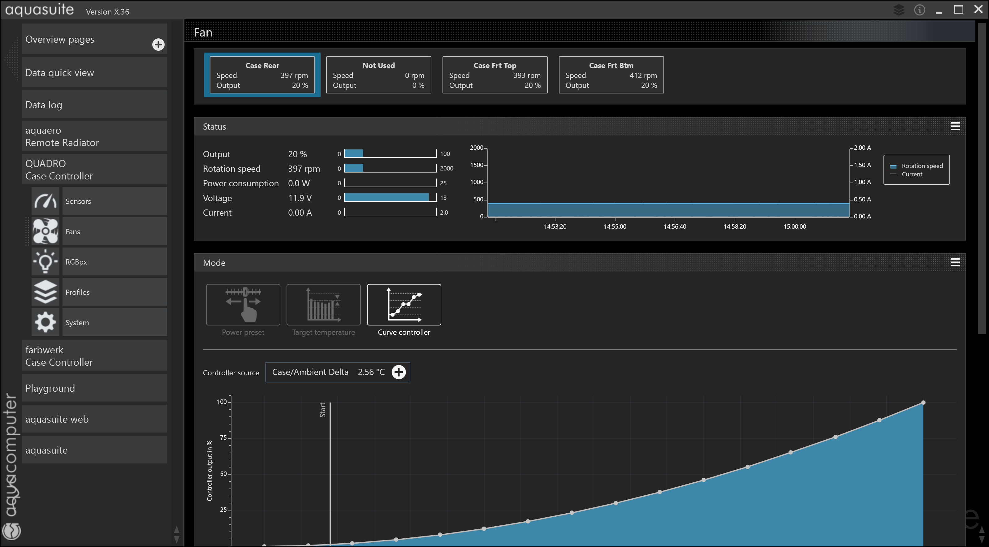

With a quadro connected to aquabus i can control all the fans independently using aquasuite ?
Yes.
You need to make a Firmware Update on the Quadro first, which requires USB Connection. Once that is done, you can unplug the USB and control the Quadro with the Aquabus.
RGBpx Functions will be unavailable when using Aquabus connection only.
If i plug that into USB only, will the aquasite software be able to control the matching fan ?

Yes, with USB the quadro will have a tab in the aquasuite, and each of the four fan ports will have its own controller.
