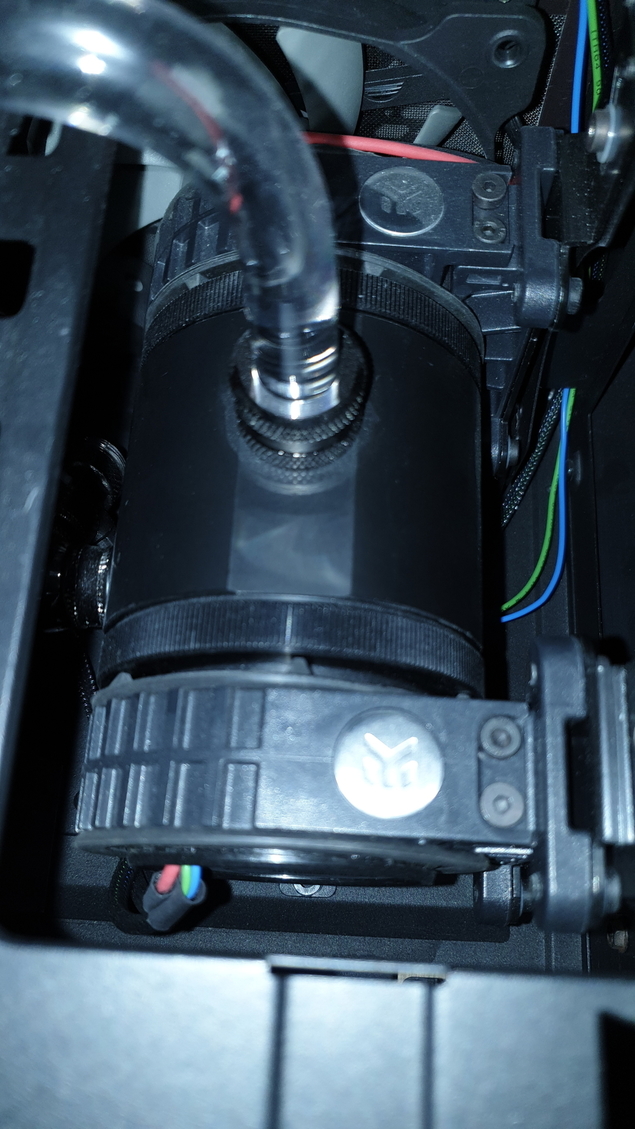

Twin D5 using Duel Revo, all EK. Never heard any sound from my pumps, good anti vibration :)
Bartdude a envoyé le fichier suivant :
  • pumps.jpg (595,6 kB - téléchargé 214 fois - Dernier téléchargement : 29 septembre 2026, 07:16)
EK Revo mount is one of the best on the market, if not the best D5 mount in case of anti-vibration. I have EK D5 combo res with such mount, it is queit, though I still managed to make additional antivibration rubber standoffs between Revo mount and case panel its mounted on. There is never too much antivibration :)
