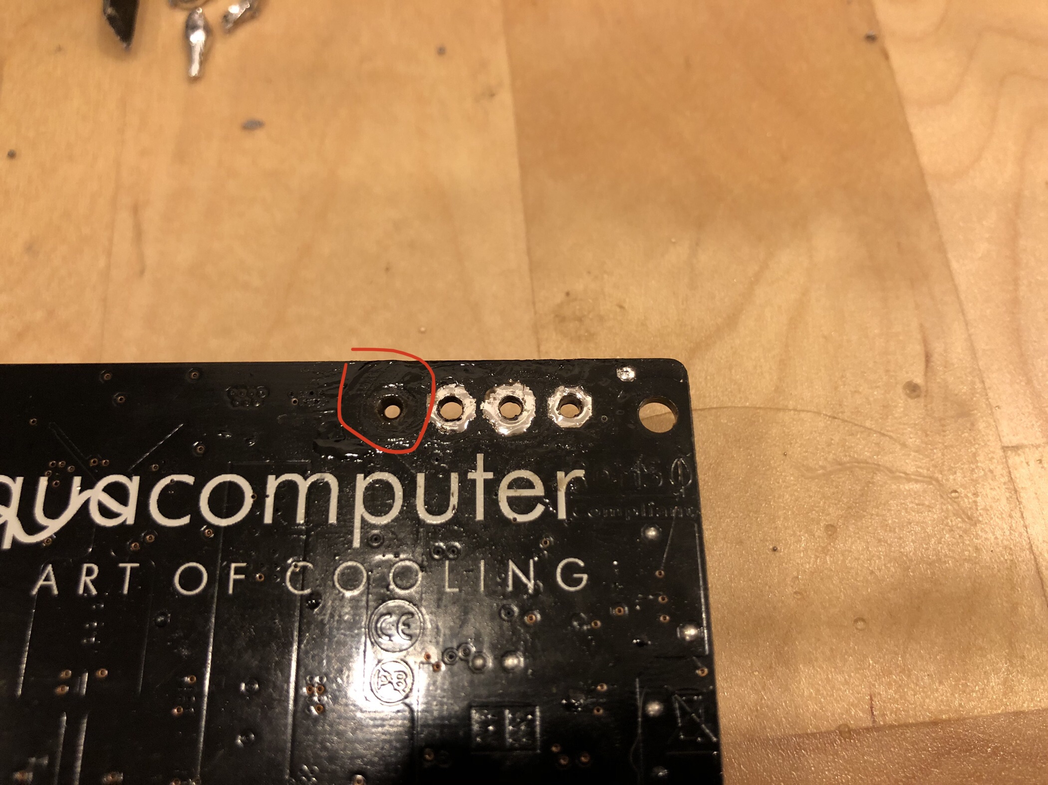

I think I over heat the board and the ring comes off, Is there any way to fix it? Any tips will be appreciate.
Thanks. Pics attached

The 2 Pads in the middle are ground. This 2 pare are connected in the bottom pcb layer. I think you pcb is working, you have only connect the 2 Pins on the bottom layer.

Unfortunately the back ring is off too. I tried to solder it directly on the board but it won’t boot the fans.
What is the ring called? I’m think buying some online to replace them order to see if it will help
Back pic attached.

this is the 12V supply, the pad is directly connected to a inner layer.
you can try to connect the 12V supply to the + connector from the capacitor next to power connector.

Is this you're talking about?

no, this is the Ground Terminal.
