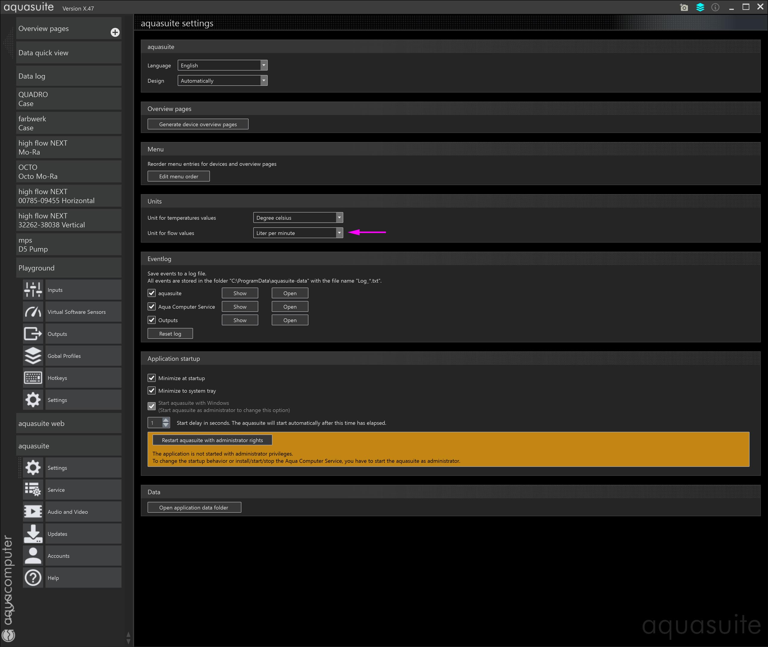

  • aquasuite set to l/m {set.jpg}

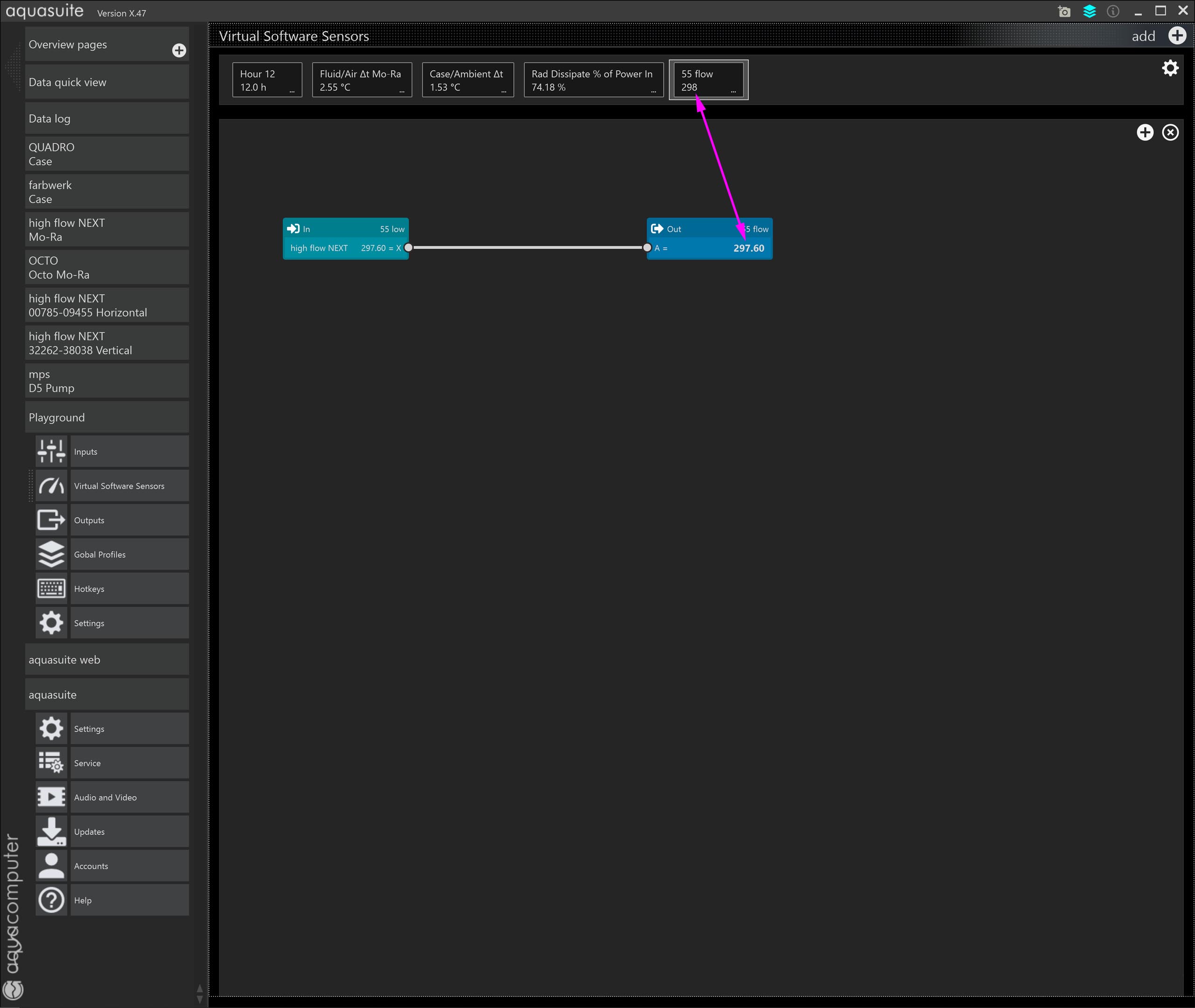

  • set virtual sensor out unit to l/m - output sensor shows unit as l/m but value is l/h {expected.jpg}

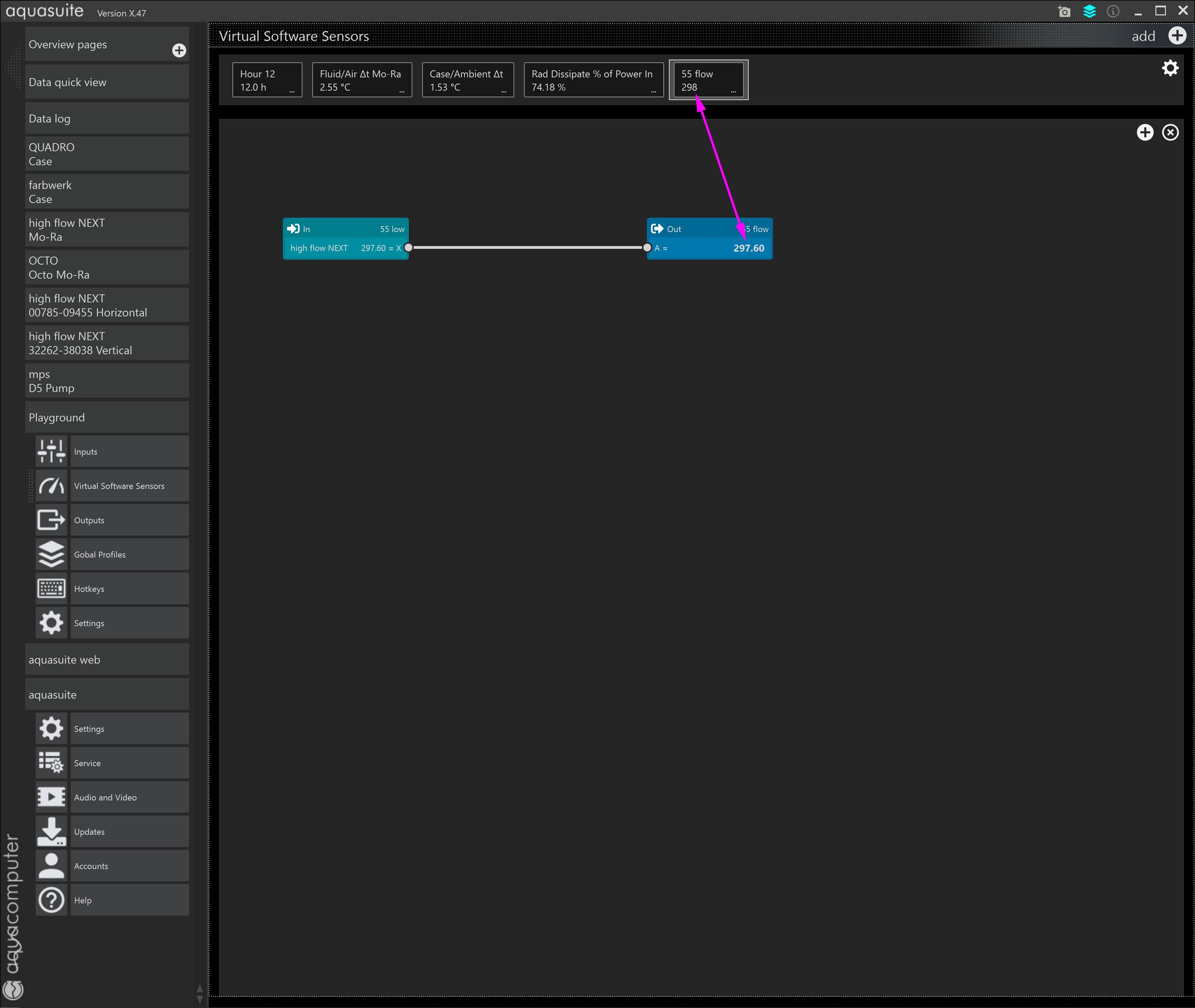

  • set virtual sensor out unit to l/h - output sensor shows unit as l/m & value is l/m (OK by me, just want to be sure nothing breaks) {unexpected.jpg}
I cannot get a l/h unit displayed for a l/h value

This is the normal and expected behavior of the software.
Temperature and Flow units always converted in the unit/scale from the settings.

Yes, I understand you designed the aquqasuite with the internal conversion for flow & temp.
But I was surprised to see the unexpected result of the designated output unit of l/h to automatically be converted to l/m on the virtual sensor final result. {unexpected.jpg}
I was also surprised to see the virtual sensor to display integers only if no unit type is designated on the output. {no_unit.jpg}
