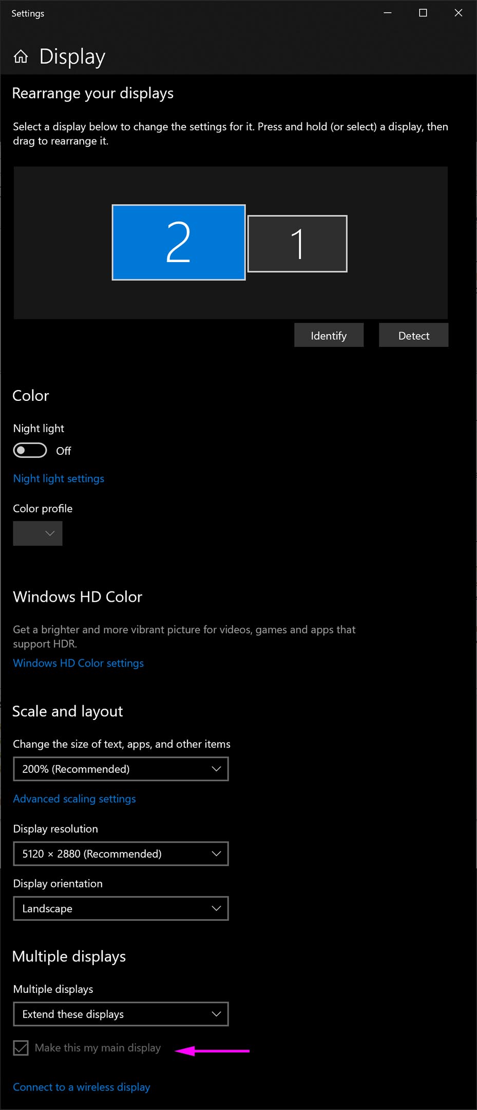

I am wondering if it has something to do with where my 2 internal displays are in the Windows raster. I have 2 main 1920x1080 displays side by side and 2 internal displays. The first one is 1024x600. The second one is 1920x400. In the Windows raster, the 1024 x 600 display upper left hand corner pixel is at coordinate (1921,1081). This places it directly below the right hand main display. The 1920x400 panel upper left hand corner pixel is at coordinate (3841,0). I originally had only the 1024x600 display and I set it so the upper left hand corner pixel was at 0,0. It worked OK but I kept having Windows apps (including AQS) jump off the main display onto the 1024x600 display. I thought ,maybe if I moved the display in the raster so it wasn't at (0,0) that Windows would stop throwing apps onto the display. It seems to work but occasionally an app will still jump onto the 1024x600 display. Now that I added a second display with a completely different aspect ratio, things got a bit more complicated. I drew a picture of the display layout which makes what I did much easier to understand. I don't know if AQS cares at all where displays are positioned in the raster but how I have it set up is kind of odd so maybe that is causing the problem. Here is a LINK to the picture. Thanks again.

I believe you may have found your issue... the aquasuite is probably displaying your display page where there are no monitor pixels.
What is the x,y of the upper-most/left-most object in your page?
How did you set up the relational position of your various monitors?
I use the 'Display setting' (screen_setup.jpg)
fyi: all the zero values in your diagram are ones, not zeros.

I use the 'Display setting' ([attach]8950[/attach])

It all sounds sensible, but how did you specify the 1024x600 pixel display has it's 1,1 pixel at the 3841,1 position in the display matrix?
And the same for the 1920x480 monitor's 1,1 position being at the 1921,1081 position in the matrix?

Thank you. I feel like I have not done a great job of explaining this whole 2-panel setup, but while I did think it may be causing my issue, the fact that the same exact thing happens with an AQS generated panel, and the fact that it works perfectly if I manually load the 2-display panel makes me think that something else is going on that is causing any auto-loaded panel to immediately unload.
As for how I specified the locations of items for each display, I just typed in the absolute coordinates. In the Windows raster, You can see this is the 2nd and 3rd images in the LINK I posted.
The 1024x600 panel is to the right of the right side main display, and up at the top so the first row of pixels have a Y coordinate of 1. So the top left corner of the top left gauge on that panel has an X coordinate of 1920+1920+1 = 3841. The Y coordinate is 1, so (3841,1). That is what I typed into the X and Y coordinate for that top left gauge. The 1920x480 panel sits under the right main panel in the raster. So the coordinate of the left most gauge on that panel is at (1921, 1081) so that is what I typed in for the coordinates of that gauge. I had to position each item in both display areas based on these starting coordinates. To AQS it's one page. It's just set up so part of it is in one area of the raster and part of it is in another area of the raster. It took awhile (and a calculator) to do, but it worked out fine and auto-loaded fine at first but then it stopped working. At first I thought it was not auto-loading but when I watch closely I can see that it does auto-load but a split second later it unloads. I can manually load it and it works fine.

In your 'Display settings' (at the bottom), have you designated page 2 as your main display page? (display_setup.jpg)
I believe that defines the 1,1 of your display matrix.

Yes display 2 which is the left main display is designated as the "Main Display" in Windows. My coordinates are working fine, as is the 2-dsiplay page. It just won't stay loaded after auto-loading. It I load it manually it works fine. Same for all of the overview pages, including the AQS generated ones for my Octo and Farbwerk360's. They all auto-load for a split second and then disappear. I checked the coordinates for some of the other custom pages I made. There were some that I had entered a "0" for an X or Y coordinate (same mistake I made in the drawing I linked earlier). Maybe doing this messed something up. I am going to make sure none of my page items have a "0" as a coordinate, then export the ones I want to keep, then try a full uninstall / re-install. I have feeling this may fix the issue, so thank you for pointing out that the first pixel is at (1,1), not (0,0).
