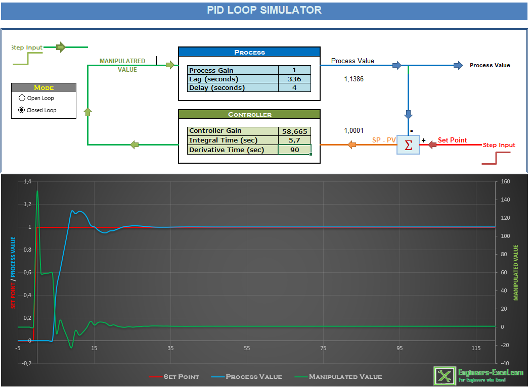

Hi all,
When utilizing a step response curve to calculate the closest control variables for the fan speed to water temperature curve, I end up close to use a factor 1000 for the PID variables.
Maybe I'm not using the right values or my calculations are off, but I'm trying to understand why;
P = 2000
I = 1500
D = 0
for normal response and;
P = 4000
I = 3500
D = 1000
for the fastest response when mine are;
P = 9000
I = 30000
D = 700
for an aggressive but more accurate response.
What gives?
RBMDragon
lundi 28 février 2022, 12:30
Hi again,
For those interested;
I've managed to dig into the PID controller tuning a bit further, and I've gotten closer to a better system, but it is still a bit unstable.
Using the Excel provided: Engineers-Excel.com: PID Loop Simulator
I've come closer to;
P = 14500
I = (can't remember, but less than 10000)
D = 750
It should be possible to calculate for others using the Excel file and a step response measurement of your cooling system, using one variable (MV: fan speed) and the water temperature (PV).

I might need to start posting a bit more information.
The integral was actually 14000. I still have 1 degree overshoot on the low load thermal target.
Since the integral value is that high, it might explain it.
Its reaction is really fast though.
Further information:
i7 9700k on kryos NEXT RGBpx
RTX 2080 on kryographics NEXT
2x 360 40mm Primochill radiators
6x Alphacool 120mm Aurora
D5 NEXT pump
Leakshield
My step response results:
Process Gain: 0,6 (0,6xxxxx, precise number is in my calculations)
Tau (63,2% of the total step response change): 336 seconds
Delay time: 4 seconds
Edit:
Fan controller change (MV): 15-90%
Temperature change: (PV): 9,7 degrees (35,34 to 25ish)
Ce message a été modifié 1 fois. Dernière modification effectuée par "RBMDragon" (1 mars 2022, 08:11)
RBMDragon
vendredi 4 mars 2022, 20:53
Changed the variable factor by 100.
The reponse is not as agressive or fast, but it seems to handle a Heaven Benchmark.
Step Response 90 is the data I recorded for the PID value calculation.
PIDLoopSimulator was used to estimate a controller reponse, although the loop is still much slower.
I used the guides from Engineers-Excel.
The gain was the factor between the change/full range, i.e. 1.
The 336 seconds is the time it takes for the temperature change starting to 63,2% of the final value.
The delay is the time it takes from the 15%-90% step change to notice a temperature change in the temperature.
PIDValues are the factors I inserted.
Setting Integral and Derivative to 0.
Set the Controller Gain until the simulator oscillates (not getting stronger or weaker).
Set the Controller Gain to half that value.
Set the Integral value until the Process value gets as close to 1 (I took the value at 100 seconds)
Set the Derivative value to reduce overshoot (second sheet take maximum value from the Process values)
PIDControl is the controller in action while running Heaven Benchmark on the GPU.
There are still some things I might do better, but for now I'm starting to get progress.

ronzino
lundi 13 juin 2022, 01:39
"I used the guides from Engineers-Excel.
The gain was the factor between the change/full range, i.e. 1."
It is not clear to me neither in the Engineers-Excel guide nor in your calculations why Gain=1.
In you calculation the gain should be G=deltaPV/deltaMV so (25,6-35,1)/(90-0) = -0,1. ?(
as well as in the web site mentioned it should be (110-100) / (55-50) =2 ?(
Ce message a été modifié 3 fois. Dernière modification effectuée par "ronzino" (13 juin 2022, 01:41)
