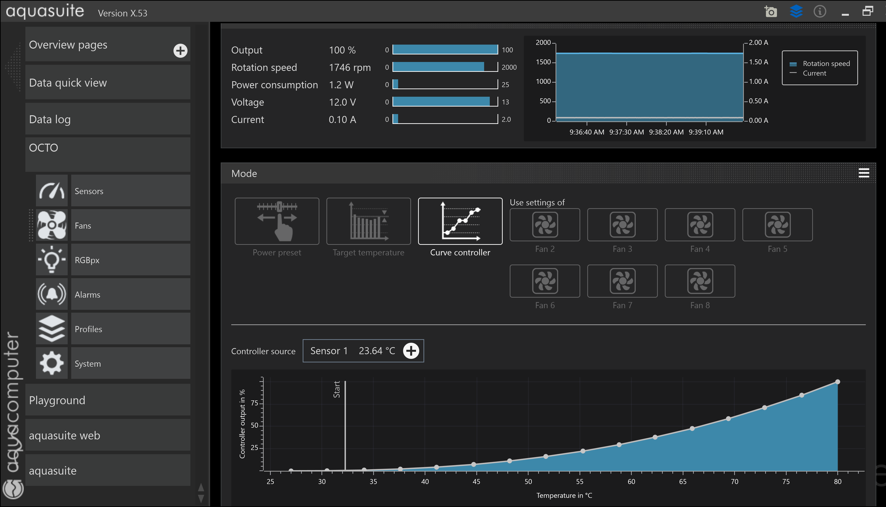

I own an octo and never have any problems but a few nights ago I shutdown my pc for the first time in a while (besides restarts for updates) and when I turned it back on my fans are stuck at 100%. Aquasuite always resets to power preset instead of the curve I was using and no matter what I put the power preset to or make a curve for the fans don't change and just keep blowing full blast.
If I close and reopen the software again it's back to power preset and the curve is lost. My virtual sensors are still available.
My computer is literally unusable like this. I have 7 fans and two radiators so when they are going full blast like this I can't even hear myself think.

I don't use profiles and never have and the fans wont reflect changes
done to them live. I can do any changes I want and nothing actually
changes. Closing and reopening the software reflects that the settings
aren't saving at all either. Yes I have tried unplugging my psu and discharging any residual power which is actually my first step in troubleshooting anything. Again I don't use profiles and the profile switch is turned off but it shouldn't matter. I didn't update the software or anything since it was working before.
If I save my settings to the
profiles (all of them) nothing changes but next time I start the
software it says "device and profiles don't match" because again it just
defaults to 100%. If I click a profile it will change the settings
reflected to w/e like if I set it to 54% output or something, but again
the fans wont actually change they just stick to 100% and if I close and
reopen the software yet again it is defaulted to 100% but again it
doesn't fucking matter because changing the settings doesn't reflect to
the real world and my fans still sit there at 100% and the software
still reports them at 100%
Here after opening software. It is defaulted to 100%
Here I've changed the settings and the output doesn't change
Here is what I see if I click curve. It is defaulted to not having a source
Here I have added a source but it doesn't matter because again the fans wont reflect any changes made
And
again here is me opening the software again after closing it (and yes I
click the save icon every time) back to being defaulted to power output
100% and the profiles I've saved (just for seeing if it's a profile
issue) are not loaded so it says the profiles don't match, but if I
click a profile the settings will change to that profile but again
nothing actually changes. Fans still just blasting 100% like a jet
engine.
