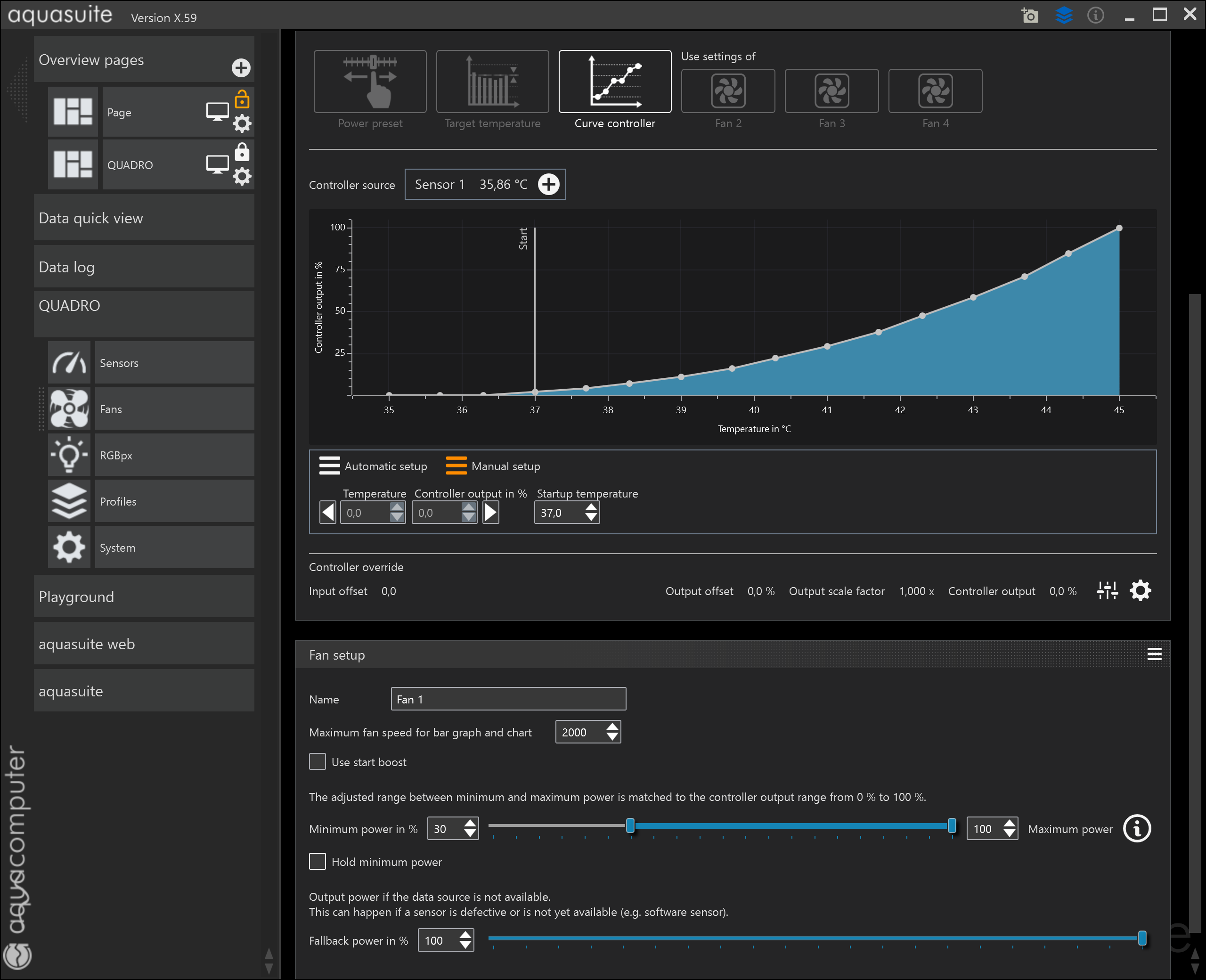

Hello! Recently I've updated my Quadro to the latest stable software and firmware versions (aquasuite X.59 and 1032 firmware). Previously if I unselect "Hold minimum power" and temperature goes below Minimum temperature - fan stops. When temperature goes above Startup temperature - it starts. After update the fan started to behave weirdly - it can stop without reaching Minimum temperature. Sometimes it keeps starting and stopping all the time if difference between Minimum and Startup temperature is 1-2C (without even reaching Minimum temp and changing temperature at all). Tried to reset device to factory defaults, but this didn't help. I have also aquaero 6 LT with older firmware/aquasuite on a different computer and it stops fans only when temperature is lower than Minimum, not somewhere in the middle

The fan starts when temperature is 37 (as expected) but stops at around 36.29, although minimum temp is 35
Hort a envoyé l’image suivante :

Yout first 3 point are very close to 0%.
Set only the first point too 0, all other > 0

I have "minimum power in" set as 30% and fan spins at 30% before stopping, so it should be 30 in that case, not 0?

I've tried your suggestion - and it works now. Last 3 point were indeed 0%. Thanks a lot!

It should be some kind of bug with rounding - first 3 points were 0%, but 4th - 2.1% already. I would expect 1.x% at least in between, not all 0-s. To get this I used Automatic setup.

It looks like it's a bug with Manual setup - when I used Automatic setup, I see that at least some of them are not 0-s, but when I try to select them one by one in Manual setup - they are all changed to 0% automatically, except 4th 2.1%
