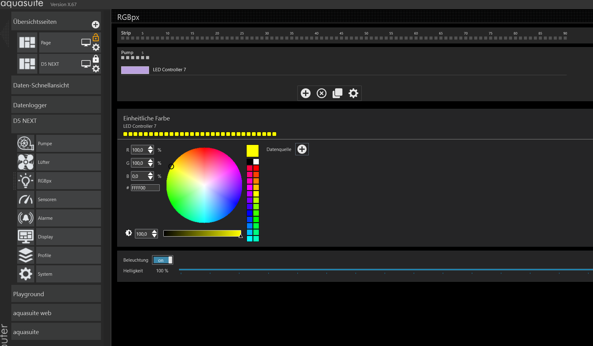

The D5 Next has 6 DRGB LEDs. You can control them in Aquasuite like any other RGBpx LEDs. In your picture it looks like only 1 LED is working, and set to white or maybe yellow. There is no way for me to tell if there is something wrong with the LEDs or if it looks like that because it is set to look like that in Aquasuite.
Thank you for your input, I checked the settings in Aquasuite and it doesn't seem that something is wrong on this side.
[attach]10208[/attach]
Well it is set to Yellow so that part is working but it looks like only 1 LED is illuminated. I would contact Aquacomputer support and ask if the LED strip in the D5 Next can be replaced. Was it always like that?
